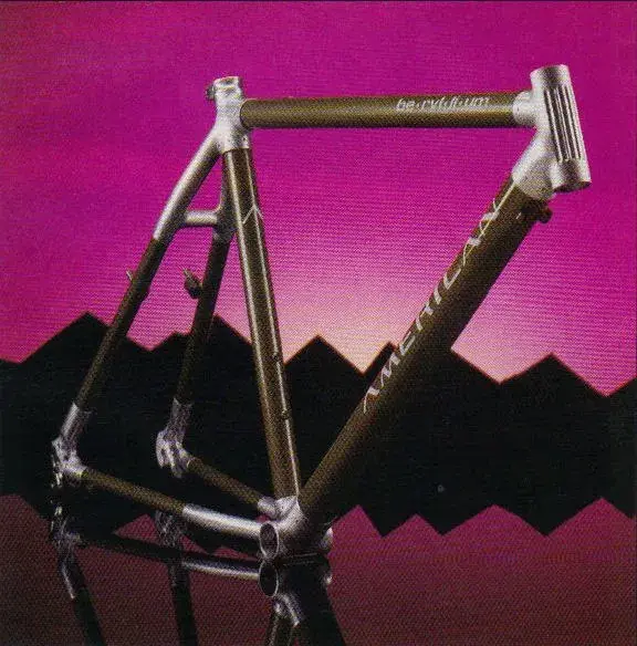

In 1992 American (the bike company) made a beryllium frame. It never made it to mass production at a price tag of 25,000$ per frame. They only made one or two prototypes so I would say your chances of ever owning that are slim to none. I attached a pic of the wonder-frame, was still lugged and bonded since beryllium can't be welded.

On the Beryllium bikes, you could try to get a hand on one of those Boralyn Univega's !!
