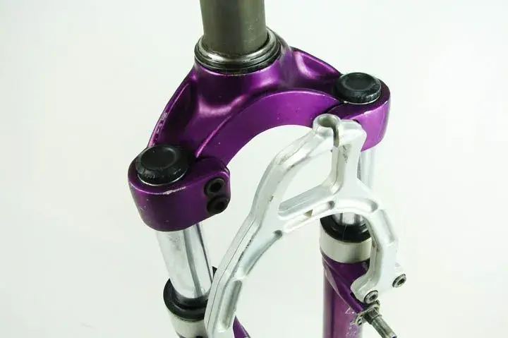

Marzocchi XC300 - PURPLE
RichieB
Bolt-in steerer.
7.5" x 1 1/8" steerer threaded
Also have threadless and 1" options. PM for details
The fork is extremely clean, and has little oil in it - but holds air.
2" travel.
I am selling it in its current condition for $150 USD + shipping from USA
I wil open it up, clean all the internals and rebuild to factory spec with current seals for an additional $70 USD.

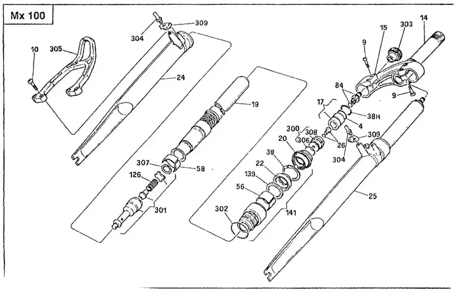

Date of manufacture, color and what it looks like.
The Internet helped me.
Do you have some additional information that might suggest something else?
Not in detail, but for sure it is something before XC400. XC400 has holes in the fork legs and another ventil cap, but most of it is the same.
XC150 is builded the same way.
XC50 has no holes in the fork legs, but is build like XC500. I'm just wondering about the time line of the forks.
So chronology is it XC150 - XC300 - XC400 - XC50/51 - XC500 - ... ?
Does someone know about MX100, XC100 and XC250 and has some details (manual, pictures ...? :-) THANKS!
I'm just rebuilding my website and try to put details in it.
Example about the informations I rebuild for one fork is here (DH3): http://dr-marzocchi.projectweb.de/repar ... occhi-dh3/
Feedback is welcome!
xc51, maybe?
tufty":1ddoafez said:
xc51, maybe?
No. The XC50/51 is like the XC500, has the same ventil and caps.
I don't understand the Marzocchi numbering ;-)
Yes, you are right. XC300 looks like the same as MX100 regarding the ventil caps.
So the question is: What is the difference between XC300 and MX 100??
