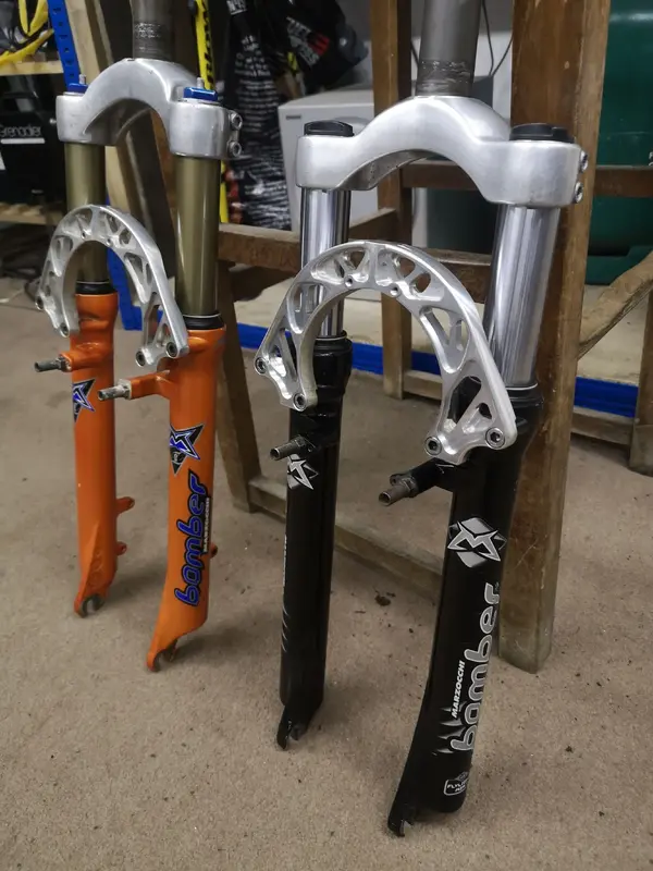

So I've just picked up these Bomber Z5 Flylight Air forks, I think they're Year 2000 as the graphics have '2000' on the sliders.
Reading the manual, it states 'Before reassembling, lubricate all parts in contact with each other using silicone fat spray.'
Google shopping doesn't have anything with this exact name, does anyone know what it is and can point me to a 2021 brand name? Or suggest an alternative that I assume needs the following properties:
1) Lubricates
2) Doesn't damage the seals or other plastic parts
3) Doesn't form some nasty emulsion when it inevitably mixes with the fork oil
Ta!

Sram butter, slick honey, Pace RC7S, just search "Mtb suspension grease" and you'll get plenty of hits.
They all do the same thing, without damaging rubber seals etc.
