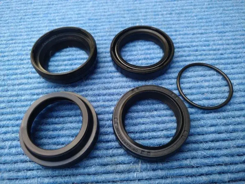

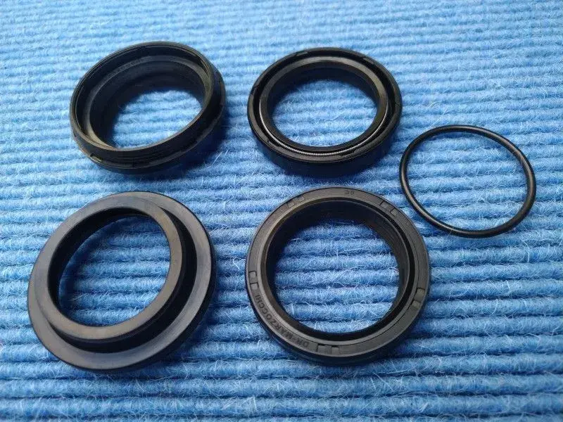

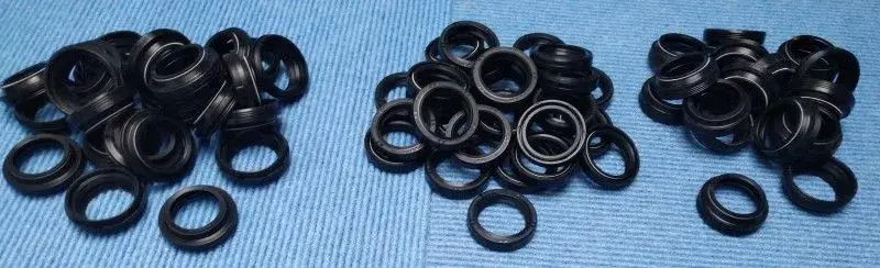

This is an old thread but if someone comes in here, it might be helpfull : I just finished my 30mm Bomber Seals Project this week and the results are realy that good as it look like 😉
