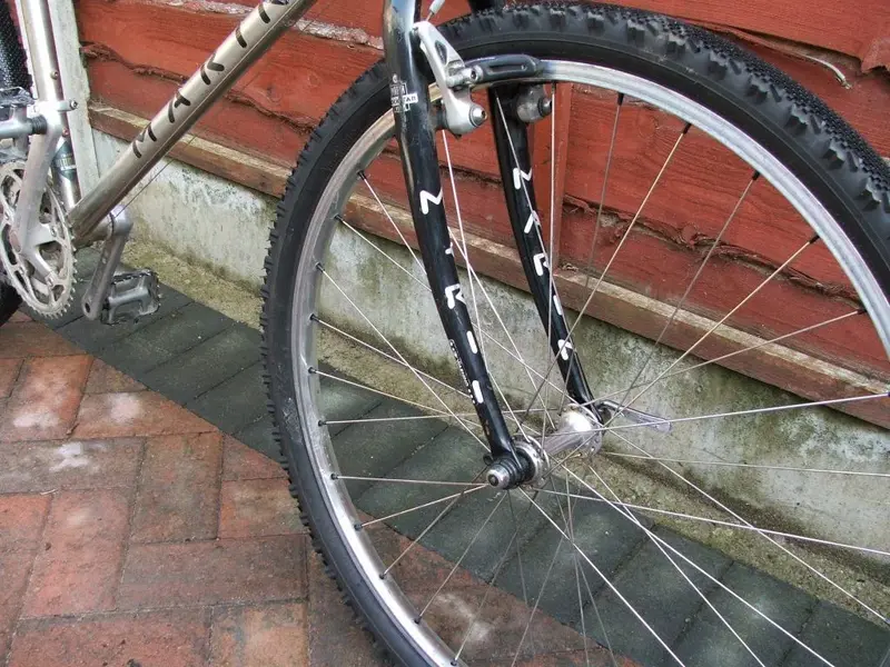

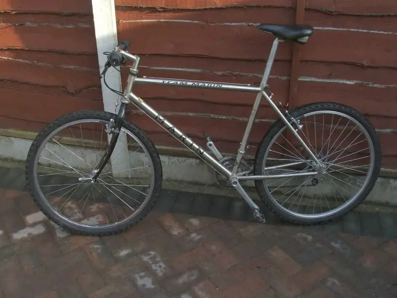

Just stripped it down and the frame is scrap :(
Better a cheap mistake than an expensive one, you live and learn.
Ah well, another excuse to trawl through e-bay :D

Marin size centre to centre so the frames are always big for their size. Wheelbase also tends to be 30-50mm longer than most. I tihnk that's what gives them the all-day kind of comfort.
You couldn't go wrong really as you were picking it up. He said as new condition, so if there were serious problems you could have refused to pay for it. e.g., the eBay picture makes it look as though the seat post is probably stuck - but evidently not, so that's good news.
Tange Prestige Ultimate Superlight was the lightest Tange tubing made, you've got good kit that could still be ok, you might even have the original ti handlebar on there, all for £73.
It looks to be a size 17.5 or 44.5cm, measured c-c, good for 5-10 to 6-0 I would guess.

It looks like the bloke you bought it on has put the front pads on arse backwards.
i believe in fixies":372h73qn said:
Nice buy!
That's what I always thought probably as I put them on the other way around for better breaking..... though harder to get the wheel out.
But it's actually correct and defied the logic of the long canti pads...

Good question, why is it scrap ?
If it is not too bad for general use I may be interested ?
