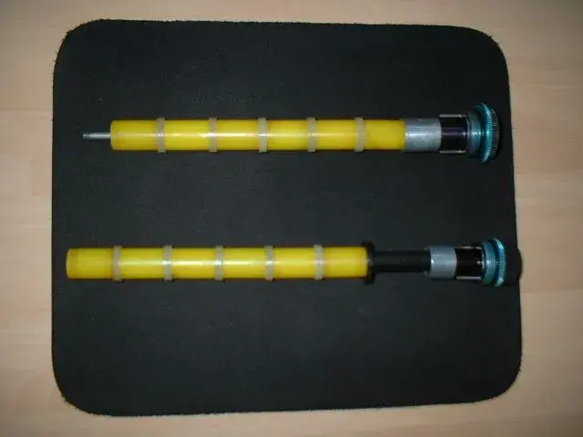

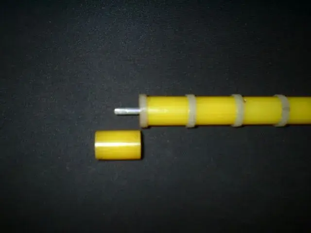

the rod that goes through the elastomers sticks out by about an inch
but on the rear " forks " , the elastomer overlaps the rod by about a half inch
so on the front the rod is partially in the plastic compression rod to start with
while on the rear it is not
so i am thinking if the rear is depressed isn`t there a chance that the rod / elastomer may shift to one side and smash the elastomers or bend the rod
when i recieved the frame one rod was slightly bent and 2 of the elastomers were damaged , but i put it down to wear and tear
do you think that this is what has happened
and should i get a longer elastomer rod made up , i dont think it will make a lot of difference to the internals to add an inch to the length of the rod ??
any help / views ??
top = front and rear
bottom = rear overlap

The rod is there to guide the elasto , so when they compress they dont loose their shape and get damaged .
If rod wasnt long enough, that is probably waht has happened . The elasto dont seat in a nice straight position and gets damaged .
If there is room , try a longer rod .
cheers chris

Slim,
Would it not be easier to move the stiff black plastic to the bottom of the stack on the rear, allowing the inherent stiffness of the spacer to accomodate for the shorter rod length?
This would allow the appropriate number of elastomers to prevent excessive sag and provide the sufficient stiffness to the bottom of the rod so no distortion will take place.
Seems to me, iirc, I had an old manitou fork that was configured in this fashion (was a bugger to get that plastic spacer out when all of the elastomers above it had turned to sandy crumbled rubber)

sorted the problem in this thread by making a pair of longer rods ,
caused no after effects whatsoever
