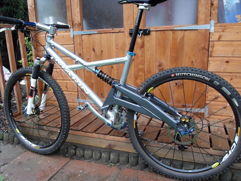

You need one of the replacement swing arms with disk tabs and canti bolts already in place. I purchased one from Marin UK via my LBS for £200 about 18 months ago. At the time they said it was one of only 2 left in the country. Give them a call, you never know? This one is fitted to an early Mount Vision 1997
Thanks, I was reading through the old posts and saw your info on the different swingarms so I am keeping an eye out for one - doesn't seem like they come up that often but I will get in contact with them and see if they have any.
