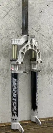

Hi guys, does anyone know the length of the original Manitou Magnum fork elastomers?
The originals were 6 divided between them by the sleevers ...

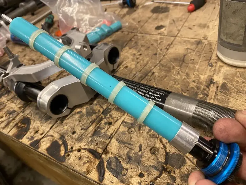

I just across this and wanted to add that I recently bought some elastomers from John for my Manitou M4's and they work like a dream now. Absolutely brilliant service and I cant recommend him highly enough!
They are 6x 1" inch elastomers + 2nd & 3rd stage elastomers (also 1" inch - sometimes smaller). Please PM me if you need perfect elastomers for your retro MANITOU forks. I do produce them custom made for your model. The example picture shows a re-build of a Manitou 3 model. They are the same elastomers as in the Magnum.
