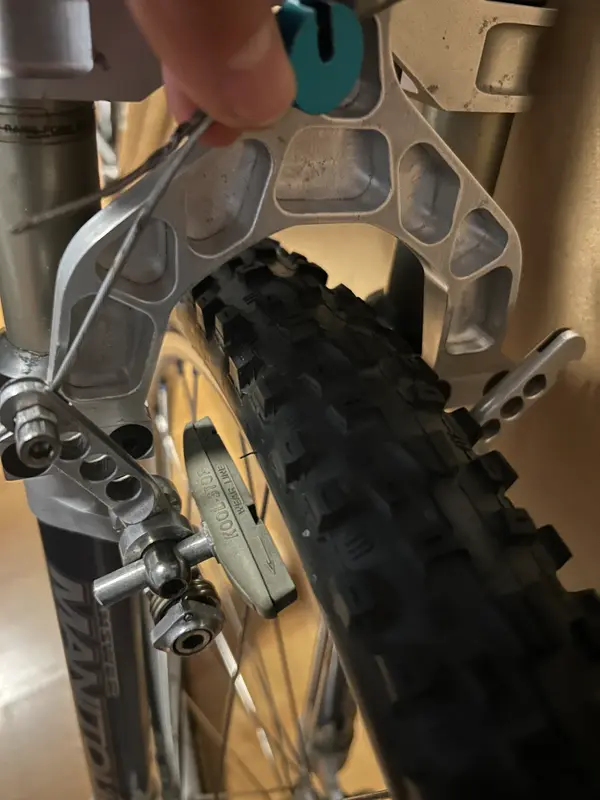

Hi all, as mentioned in title. I have a Manitou Comp fork (1995). I tried installing BR-M900 and the cantilevers rub against the brake arch.
I then tried WTB Speedmasters and had the same problem.

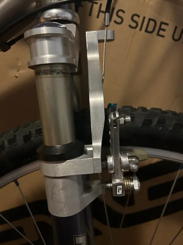

Now, I installed some Paul 'Stoplights" and these have no issue.
The M900 appear too "low profile" and not compatible with this brake arch
I did have these M900's on a Manitou EFC without issue, but the brake arch is different. I notice the brake arch on the Comp extends much more forward.. while EFC arch is flush. See side profile photos for comparison.
I guess my question is.. why is the Comp arch designed that way? Was there a benefit or just aesthetics?

The arch is back to front.
The canti hanger has been bolted on the wrong side, the cnc cut outs should be visible from the rear, not the front 👍
That's what i first assumed, but the arch is recessed at the 4 entry bolt holes only on one side, so that they sit flushed. And all photos of 1995 Comp and Magnum show the cnc cuts on the outside. I have no idea what they were going for.
V-brake wasn't around until 1996? But I do know the canti guide/stop is removable, you cannot remove it on 3/4/EFC, it's part of the arch.
Also, the Magnum and Comp do not have the same Made in USA placard featured on the Manitou 3/4/EFC
