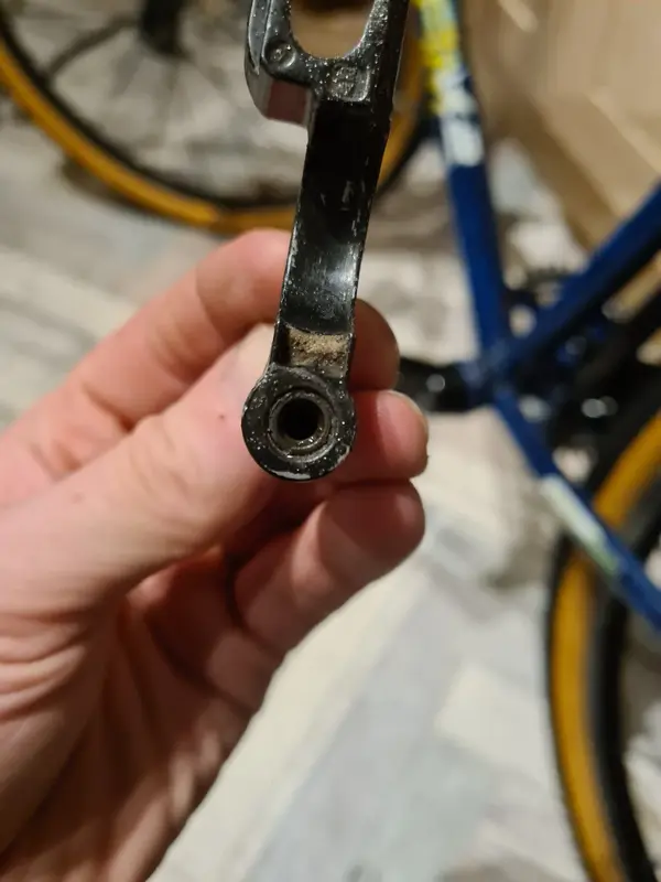

yes, the ears/arms are adjustable. Some are splined, most are just a push fit in a taper. Get a spanner on them and they should rotate, but might need a bit of force to get them moving .Obviously you'll need to remove the bolt first.

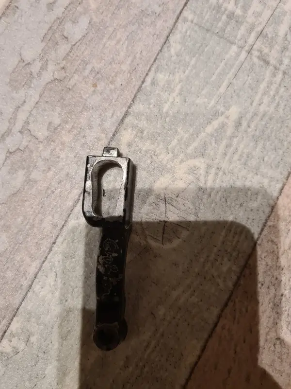

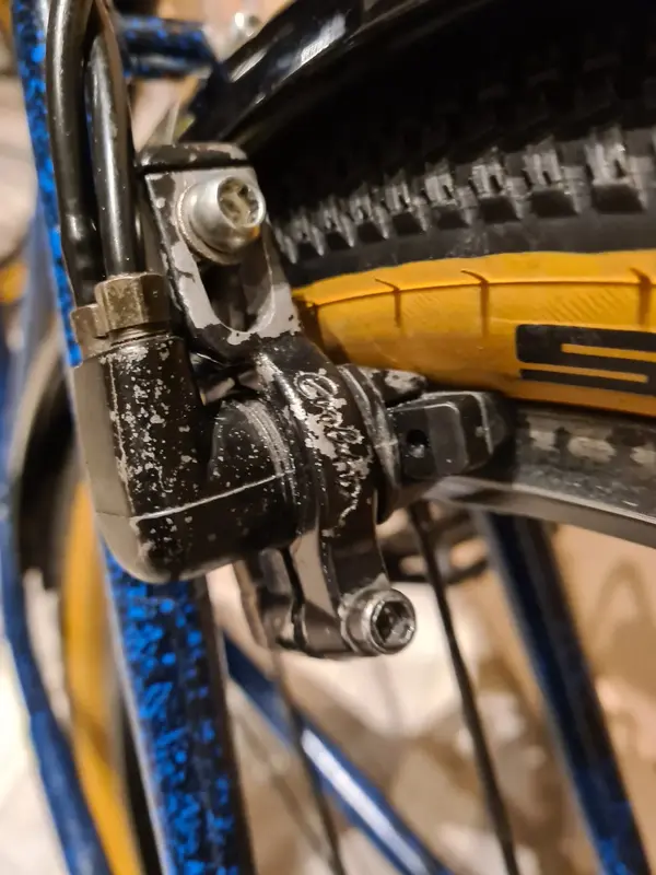

I've done all the filing, possibly too much, which is why I was wondering about spares. The arms/ears feel pretty stuck but I'll soak them in gt85, see if that helps any. I'll get pics up a bit later.
As mentioned, fitting the mounts upside down is something I've read works for u brake boss fitting. The bit I think you are talking about should be adjustable once the bolt is removed and you can push it clear of the splines.
They're already on upside down. Like I said, I may have filed too much which won't help. (It's pretty jammed against the rim in this picture but it's not set up properly). It's been so close at times that I tried filing down the arm a bit because I tried and failed to move it

You shouldnt need to file the mount like that, the mount usually has a plastic shim that is used to position the calliper inboard or outboard. It's usually a split bit of plastic with a groove/grooves on to slot into the calliper and hold it when you bolt the clamps together. It's been a while since I've worked on some, but something like that at least.
Don't remember having anything along those lines. I'll have another crack at the arm tomorrow , hopefully I'll be able to shift it and that'll give me a bit more room to work with.
