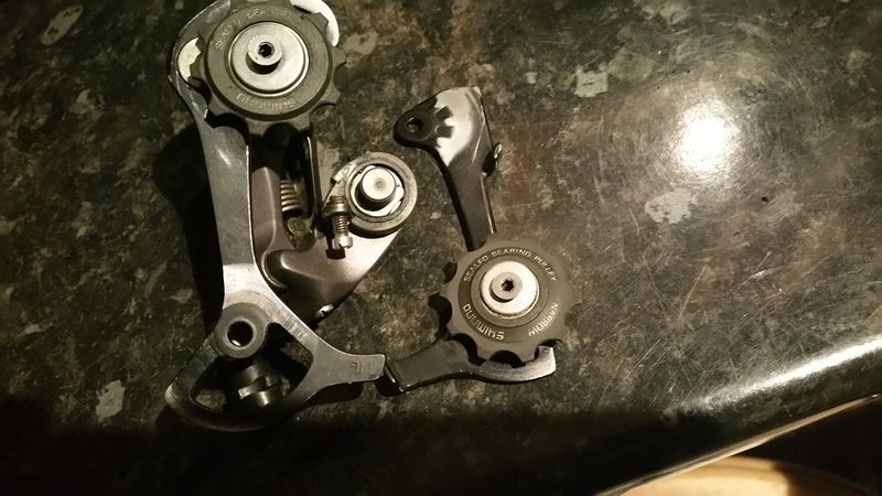

Hi I have aquire an xtr m950 and m951 rapid rise rear mech.
The jockey wheels on the 951 seem aftermarket and worn out.
The m950 ones look original shimano ones with slight wear on one side.
Can m950 jockey wheels run on 951 rear mech? I am going to running 8 speed.
Any idea where I can get new xtr m950 jockey wheels from

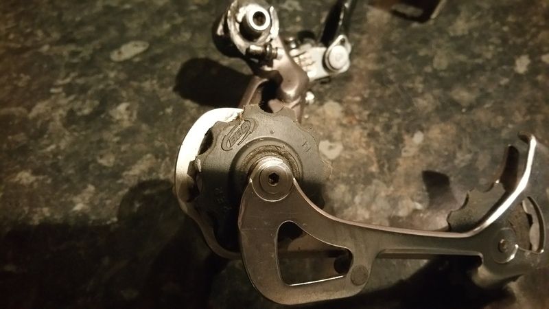

Those BBB's don't look tooo worn, but if you do want to replace them, Chainreactioncycles do have a good range of Shimano jockey wheels, usually in stock - not cheap tho for XT/XTR-level ones.. almost more than you should pay for a used XTR mech tbh! :wink:
I use the cheap Alivio-level jockeys as replacements too in the main and never found any issues with them at all; but there's nowt wrong with much that BBB make, jockey wheels included.
