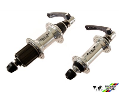

Hubs
M900 & M910

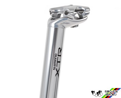

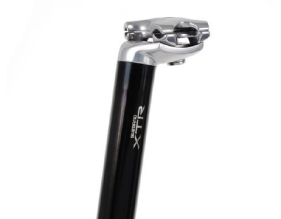

Seatpost
The M910 lighter and silver seatpost was added to the collection.
