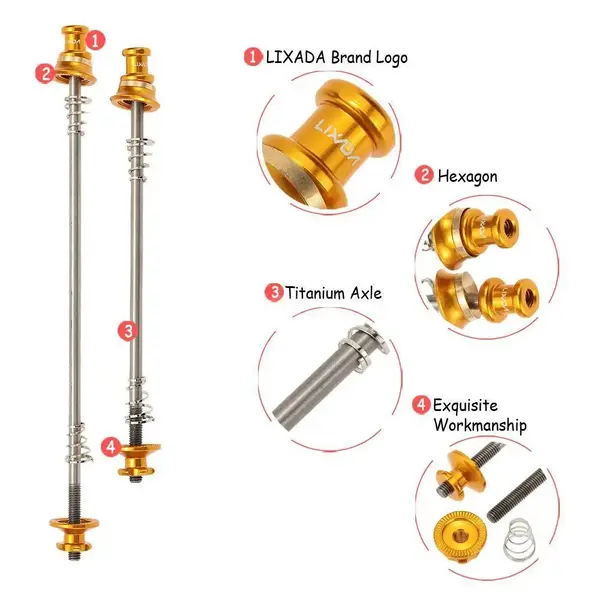

Has anyone tried these? Can be found for less than £6 on eBay.
I'd buy a set to try, but can't figure out how you'd tighten them ...

I use similar, two different brands but the skewer itself is one piece Ti, basically a very long bolt, part 1 will have recess to fit 5 mm allen key. It looks like this may be alloy so would be more susceptible to rounding, although id be surprised if it was as i dont see how the Ti skewer would be fitted into the alloy part securely.
£6 is throway money so press the BIN button.
I mentioned two brands, first lot i bought had a slightly larger hex recess so i ground down 5.5 mm allen key to fit as a loosely fitting allen key is a sure way to round off the hex recess.

Oh I particularly wanted the allen key type as these are going on the city bike - should be years of rust free use in them ...
So these arrived yesterday, looked ok in the packet.
On fitting, noticed that the blue colour is a rubbish match to my other bits.
The titanium axles are also too long, so 5/6mm sticks out past the end of the locknuts.
To top it all off, tightening requires a 4mm allen key in a very shallow recess on the 'lixada' logo end. This is really soft and a bad fit, I've already rounded one off.
TL:DR - Don't bother.
Hmmmm not good..... and one to avoid.
I think better ones are the J&L branding, but a bit dearer.
