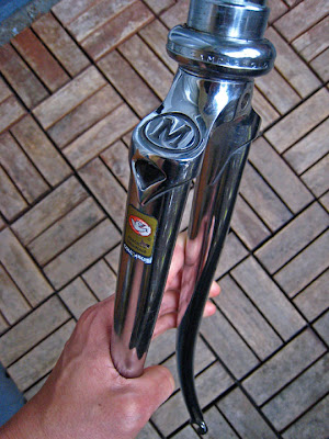

Something like this would look nice :D
Shaun

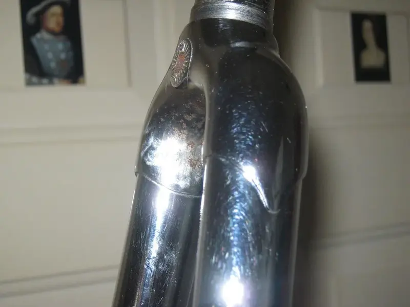

this type .[that chroming on mine looks naff ! will have to see about getting it re done...]
