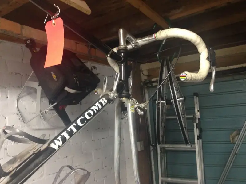

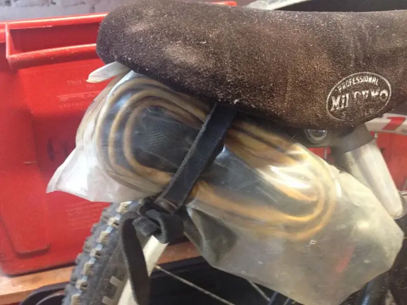

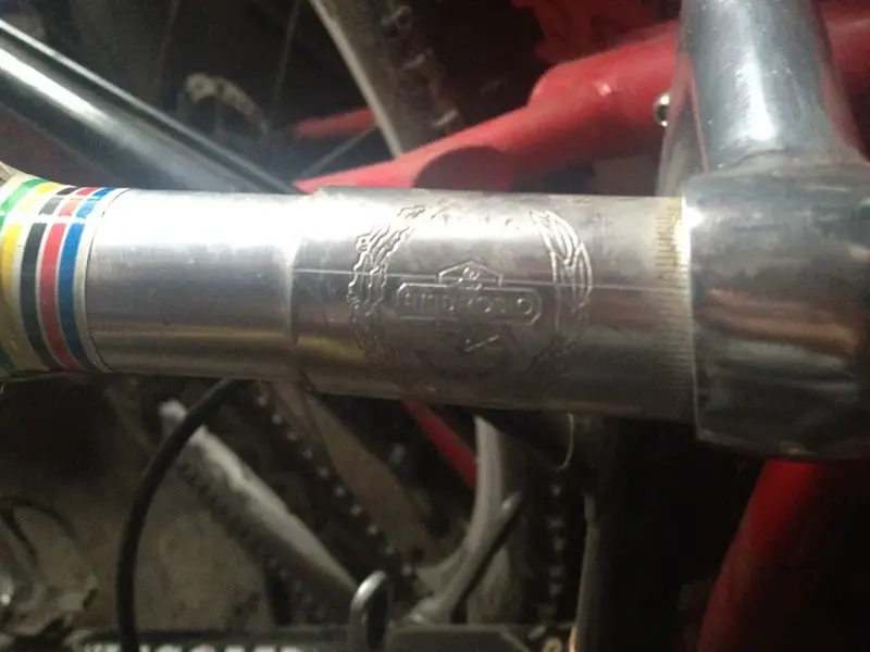

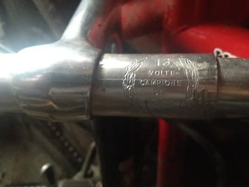

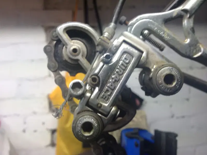

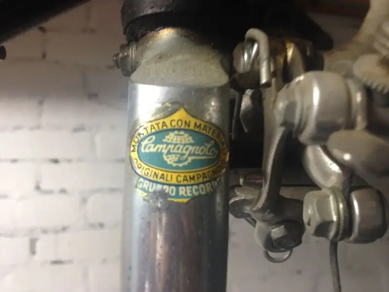

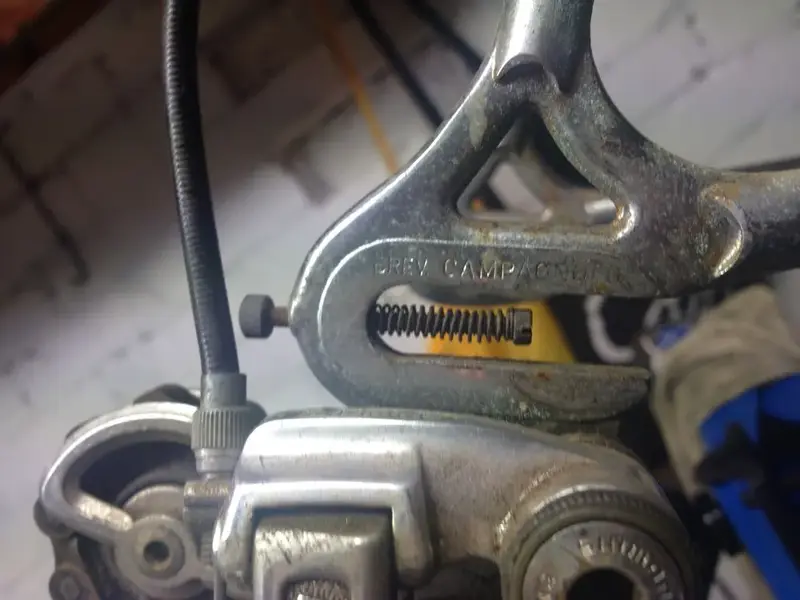

So what have we got...very nice steel frame, doesn't say what tubes, but heavy it is not, nice lugs and lining. Interesting mix of bits, Brev Campag dropouts and forks, Ambrosio bars, modolo sorting brake set, shimano 600 front mech and first series Dura Ace rear mech. Chrome forks and drive side chain stay would benefit from a bit of TLC, and a set of wheels would help. Even came with a set of very dead tubs strapped to the saddle with a toe clip strap, so hasn't been used for a while. Condition of the "suede" saddle gives a clue to how little use its had.
So now with the pictures...

Sticker on the forks suggests it was originally built with Campagnolo Record Groupset, but rear mech is Dura Ace.

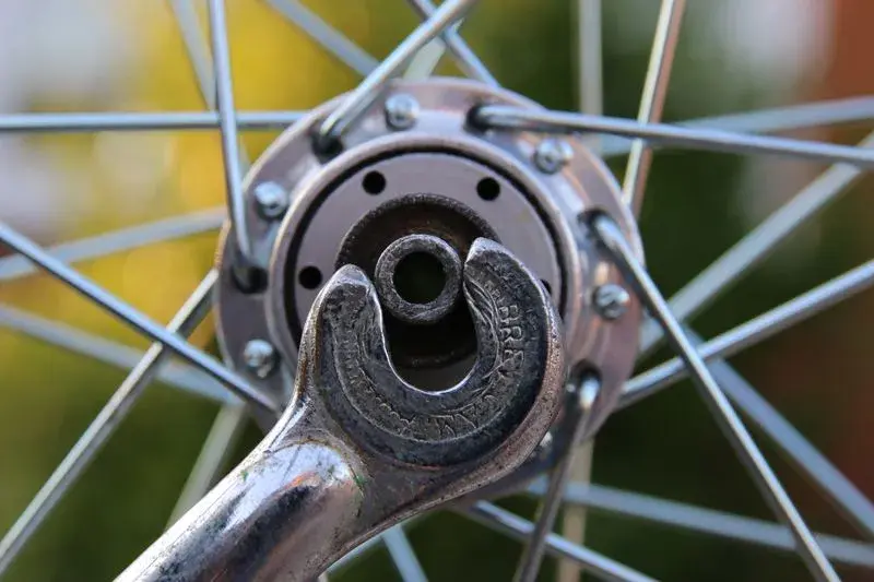

Some wheels arrived today, complete with tyres and not too spend either. Rear wheel in, no problem. Front wheel doesn't war to play. :-(
Looks like the dropout is slightly narrower than the diamter of the "axle" where it sits in the drop-out - see picture below. Tried a modern (2009) front wheel and that has the same problem.
So when did they change the axle diameter/dropout width and what are my options, other than finding another set of wheels?
