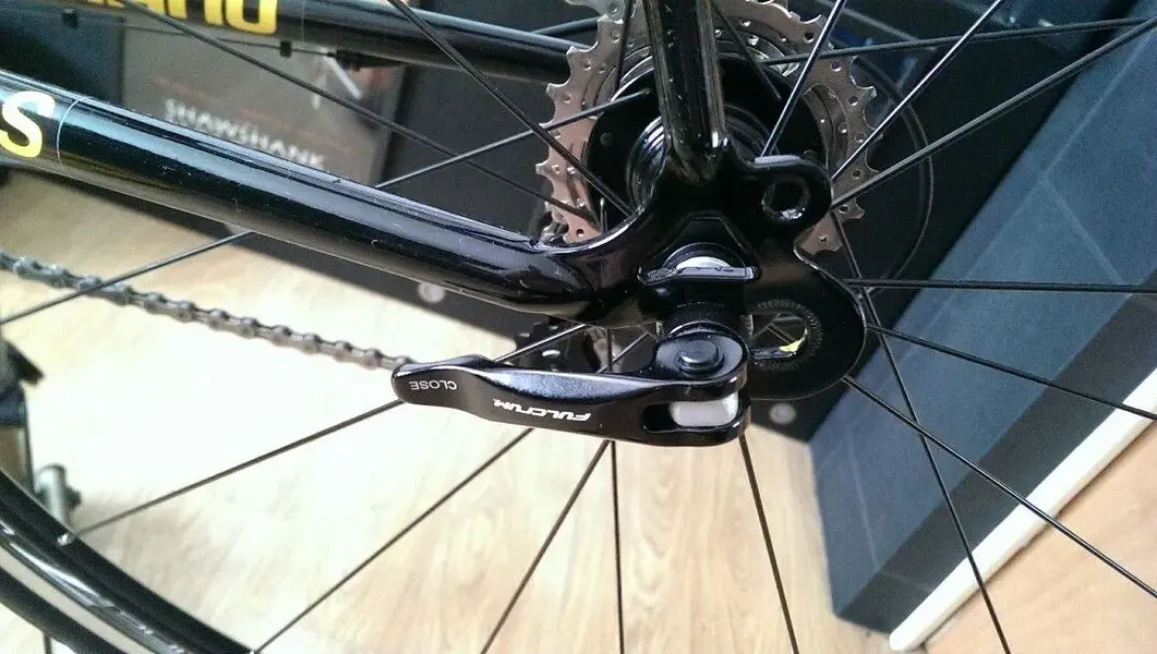

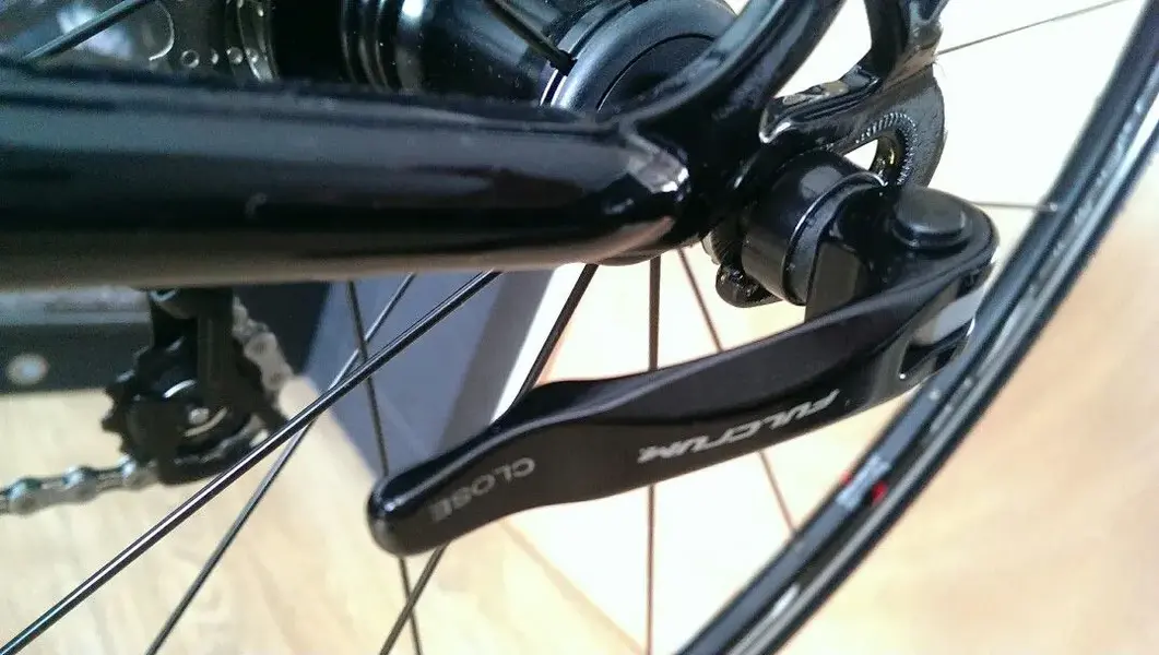

So before I cock my leg over it tomorrow I have one final q, more a concern really. It's these dropouts.
The rear wheel is right at the end of the dropouts and I'm worried the wheel may fall out. Am I safe to give this a try ?
I guess worse case is rear wheel hits frame. With the 28mm tyre on, the wheel cannot come out anyway without being deflated, but I thought I'd ask before I write it off on my first ride lol.

I've ridden like that.
Many times.
Only thing you can do is keep an eye on it. And make sure the qr is done up tight. (So it marks the drop out)
If it shifts, the solution is generally Shimano closed cam skewers. They can create some serious end load!
