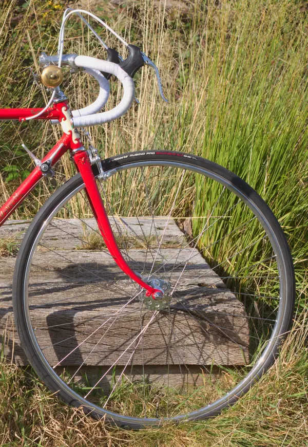

I was rebuilding a 1961 Holdsworth Cyclone last year so it pretty much had to have large flange,
but I did find some cheap early Nuovo Tipo and they look damn fine.
I also hate black bikes (in general).
Nuovo Tipo 1253 + Mavic Monthlery Pro tubular

Amber Wall tyres would lift it further. A lovely build.
