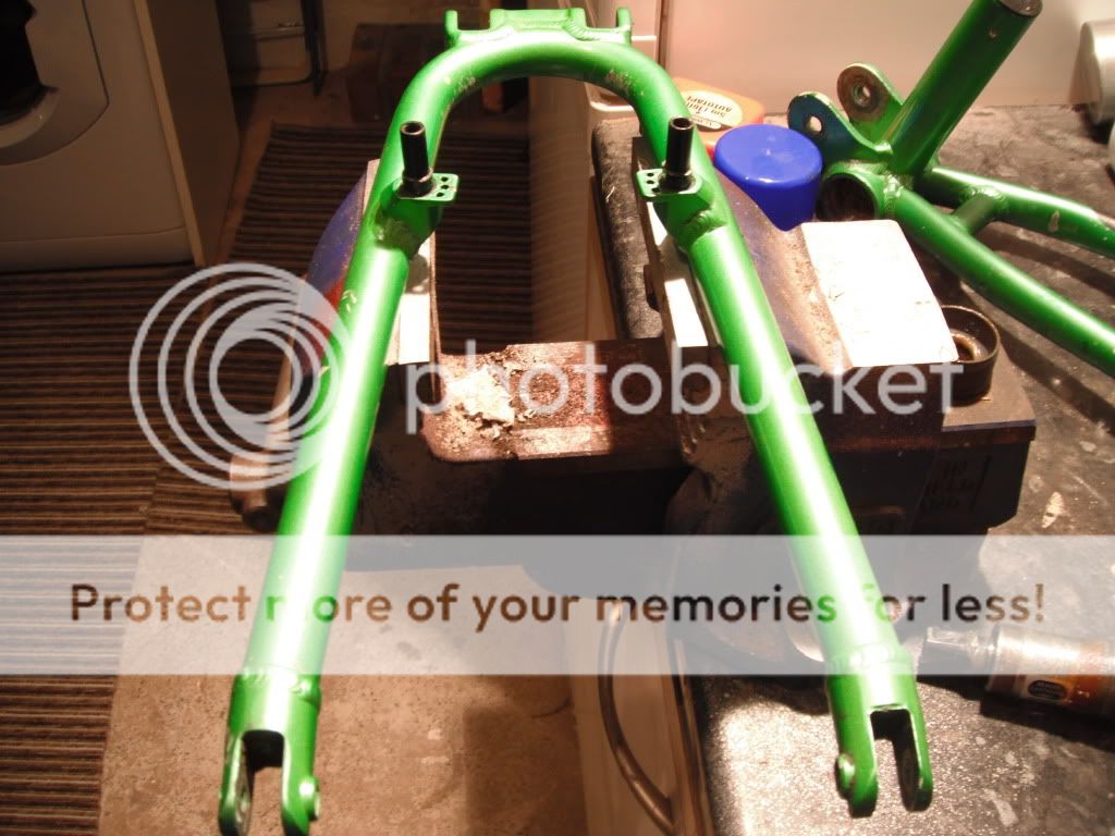

i have a kona uhu 1997 green i bought it to keep myself busy over crimbo
i have stripped the rear suspension and found the frame at the rear connecting lobes have cracks and need welded my question is what is the rear part of the frame made from as the sticker says the three main tube are easton elite 7005 aluminium ! and doesn't mention the rear and i cannot find out anywere .

just looking at the welds I'd go 99% that its aluminum but the old magnet test can prove or disprove steel. I think everyone would agree that the rear end being Ti would be ridiculous so slap a magnet on the stays, if it sticks they're steel if not aluminum.

i do have a mate thats a welder, alu tig as well but he asked what alu it is 7005 or 6061 as the latter requires pre and post heat if im reading info correct and 7005 can be done at normal temp, any-one correct me on this?

The new stay ends i had made were welded on conventionally, without heat treating.

ive seen what you had done and it looks good im not sure if just welding it is the best way forward or getting new parts done the same as you
only tonight i have been talking to my father in laws next door neighbour and he has lathes and a miller in his garage and tells me he could make them if i need them so first i will have to show my welder mate and see what he thinks :?
