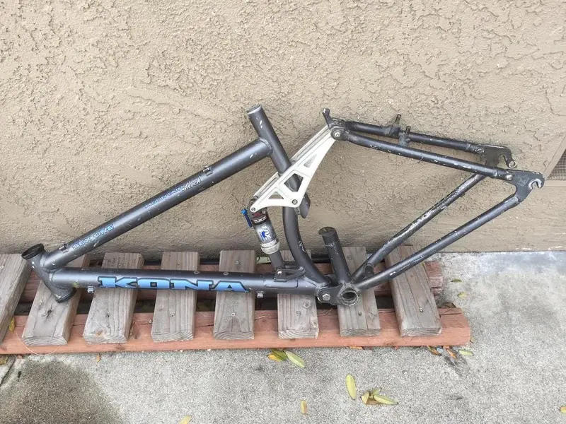

I’m not too sure if the A25 will fit your Sex one Swing arm/link. I have looked at possibly trying to get a modern rear shock put on my Sex Too but the connection from the shock to the swing arm/link (whatever it’s called) I think is different to your sex one. Not sure.

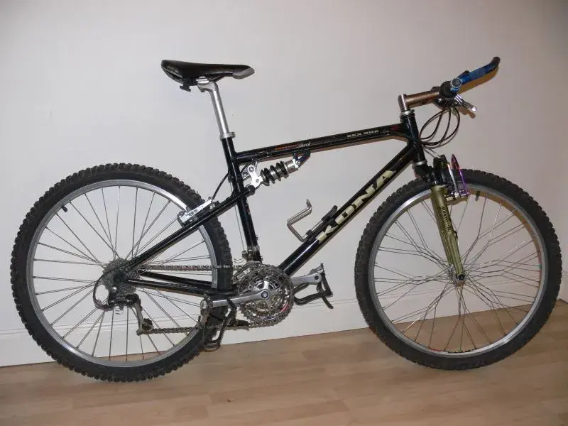

So, the saga continues.
The A25 shocks from Amazon have arrived and absolutely will not fit. The linkage is not the same on a Sex One as a Sex Too as previously stated in an earlier post but the valve end is upside down also so clashes with the frame bracket. Not convinced these shocks are built correctly as when I studied pics of original Sex Too bikes the valve is at the bottom. If it was only the linkage end I would look to have something made but both ends means thats pointless - frustrating.
On the plus side I emailed Risse Racing - no response however I notice they are now advertising a Sex one and Sex Too set of shocks - not sure if this is new or if I only just spotted it:
https://www.risseracing.com/kona.shtml
Front forks are with a local company getting serviced - due back imminently. I also asked them to take a look at the origanal coil shock to see if it is serviceable - its not. Once the forks are back and I know all is well I will purchase a Risse Racing shock.
Have been looking at how to approach the brake upgrades. Have decided on Magura Hydraulic rim brakes. Annoyingly new items seem to be similar price as retro/old so I think sensibly I will buy new - at least I know they are still supported i.e. new parts etc. Means less frame mods, no new forks, same wheels etc. etc.
Must admit I'm getting annoyed with this bike at the moment - seems to be costing way more than predicted. Guess thats something everyone on this forum says! :) Will continue though - I'm determind to ride it!
