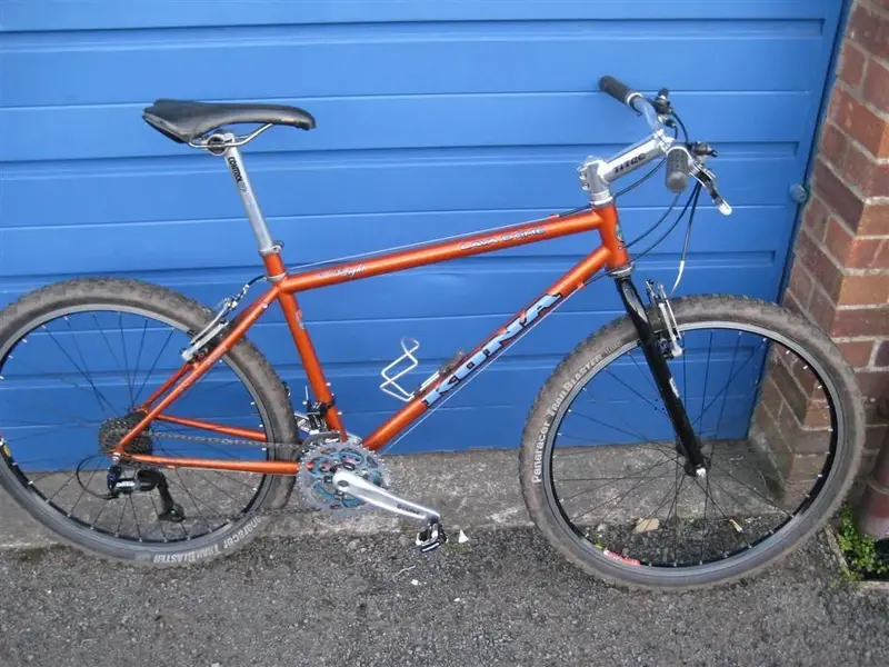

It's a 96 frame in the option green. The other colour was burnt orange (as below) and that is a very popular colour (an orange 96 with good parts made over £400 on eBay earlier this year!). So you could consider a similar colour to that as one of your options. I don't think Kona would be able to tell you the RAL number of the paint they used, if you want to replicate that, but I guess you could try them on [email protected]
Gil_M, a member on this site makes excellent decals. If he doesn't have 96 Lava Dome decals already on file, I expect he'll want you to send him high quality images of the decals you have on the bike, so don't strip it just yet!

Thanks for your help Anthony, but the one I had BITD was Green so I would like to keep it Green + I'm not really building it to sell, I want to keep it :) I notice on yours you are running a V Brake, how do you run the rear cable into the seat post guide ?
That looks very nice :)

I can't remember now whether that orange bike belongs to CCE, but anyway CCE has one and he is also the site expert on making V-brakes work on Konas. You could either do a search to find the threads he has commented on, or PM him.
I think you have four options:
1. use the canti guide that you already have - but it isn't perfect and if you do a lot of rear braking, it'll eventually wear out.
2. buy a clamp-on cable stop, which works perfectly but looks a bit clunky
3. if you're having the frame repainted, you could have a stop brazed on while you're about it - costs about £15 IIRC and you could get back a tenner of that from selling the guide, believe it or not
4. CCE's effective fiddle, whatever it is

cce's fiddle is in fact my fiddle :) patent in process-lol, I supplied cce with a small top hat washer which sits in the original guide allowing you to run a small length of outer cable & hence enabling conventional way of running v's. If you want a washer pm me address & I'll send you one ;-)
