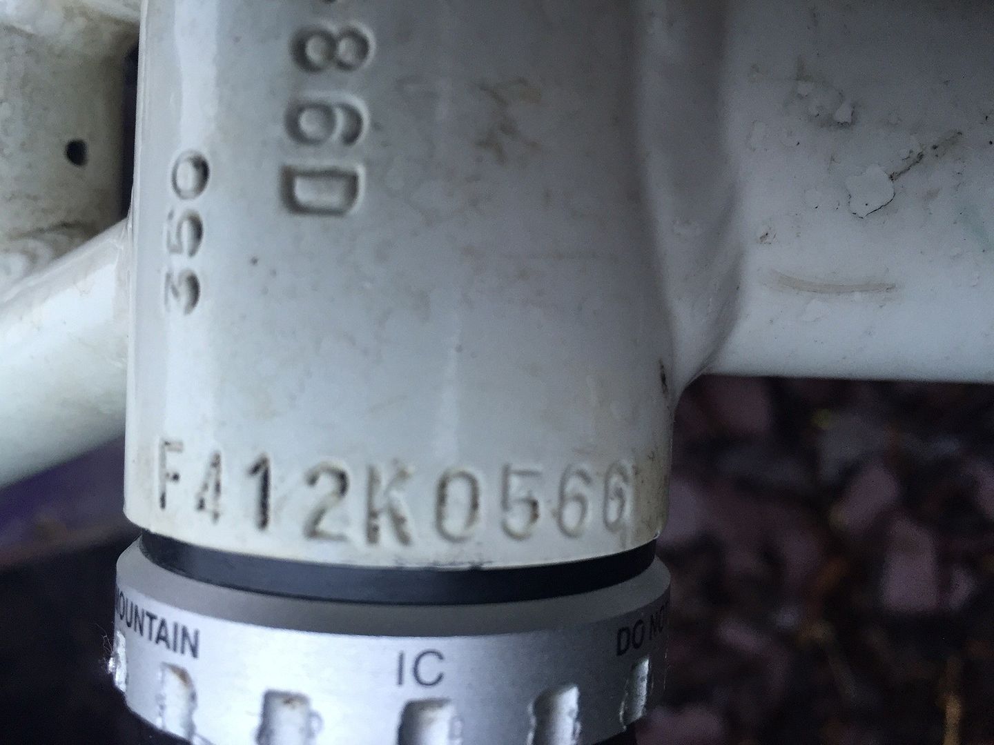

Paulbear17":197kub5p said:
A412 - U
BI - 1252
5I - 86D
F412K0566
Are the frame numbers across the BB
The frame number indicates that it was fabricated in the Fairly factory in December 2004, so is likely be a 2005 model. The question therefore belongs in the post 1998 section :wink:

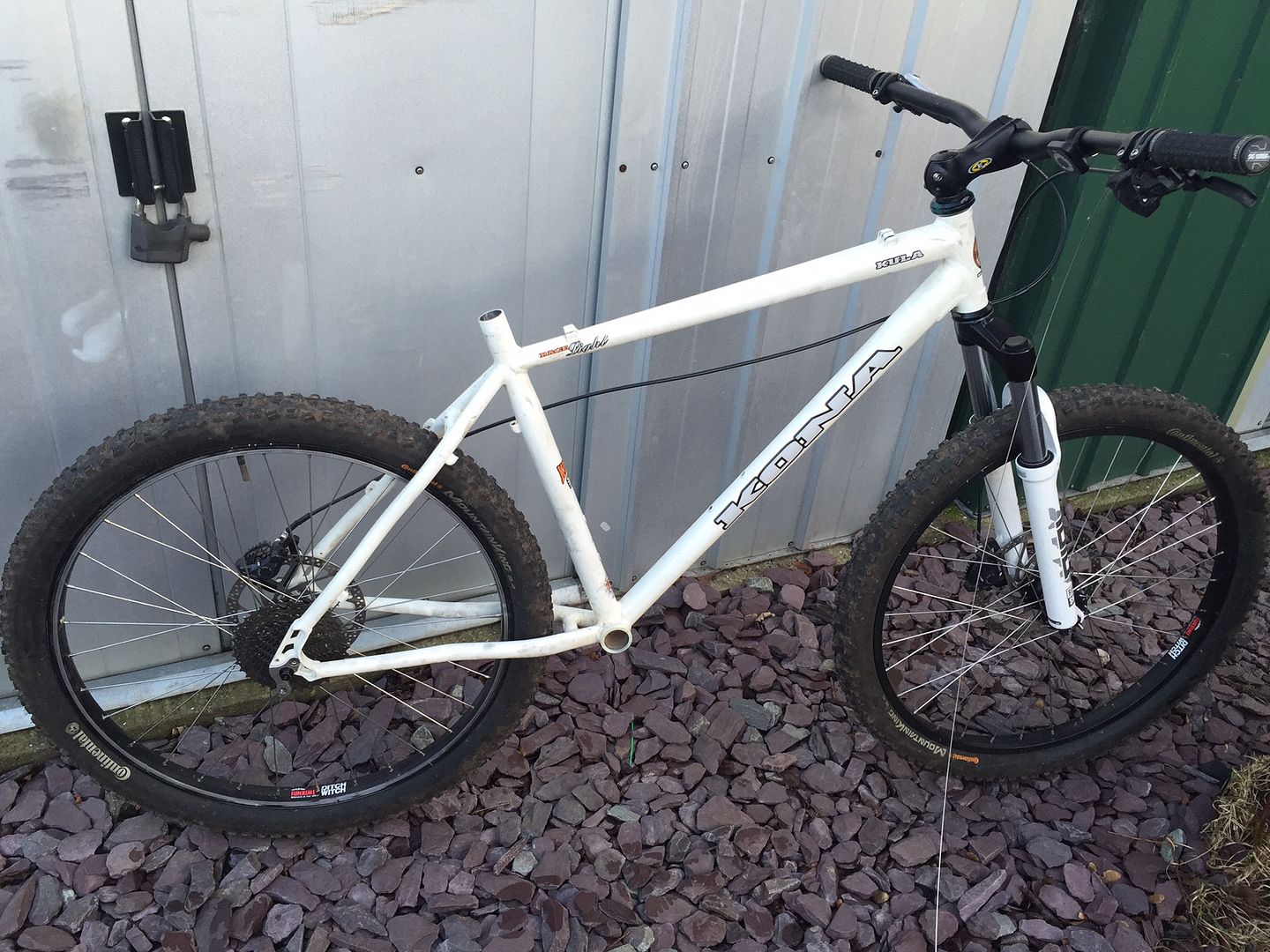

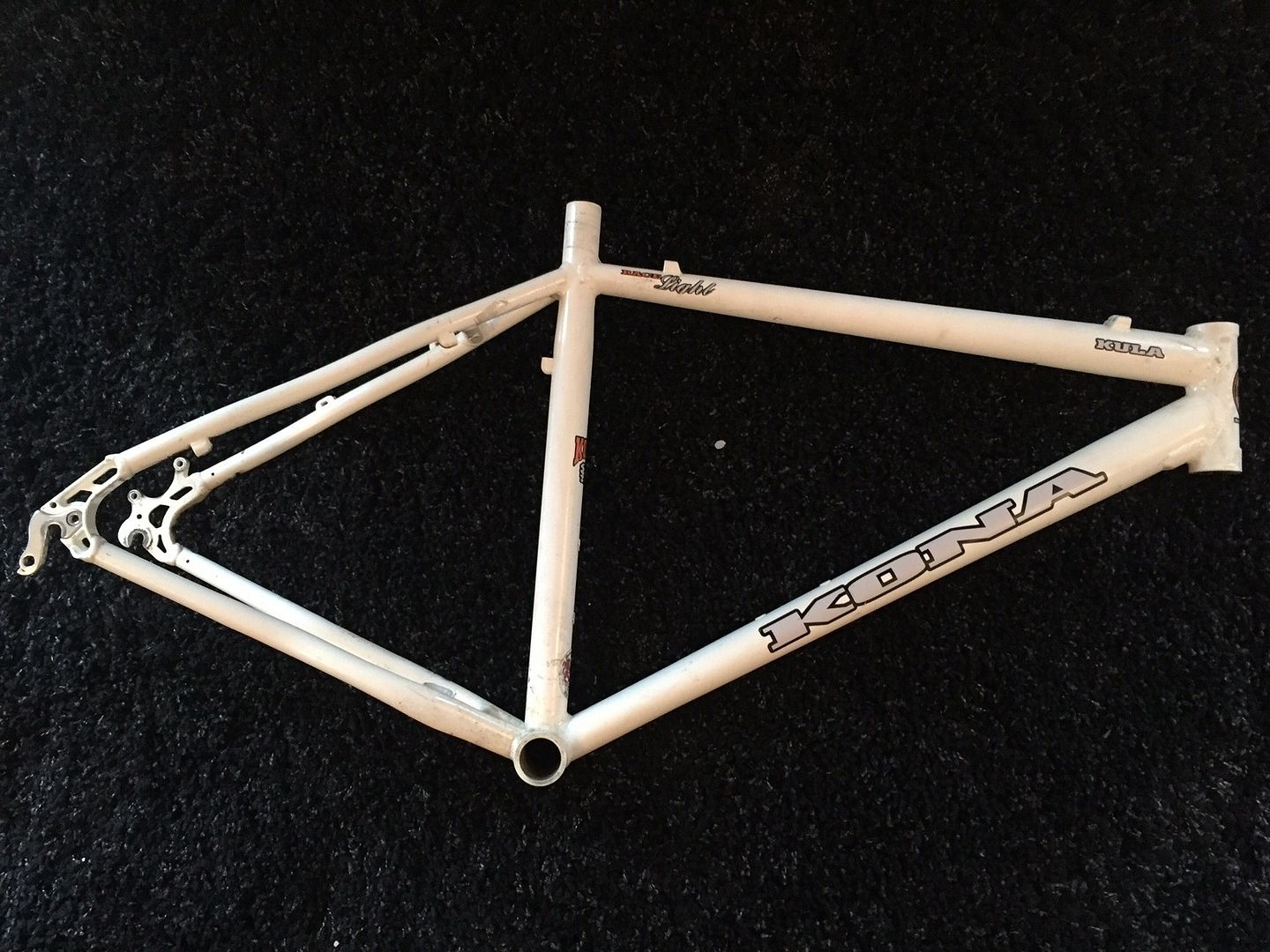

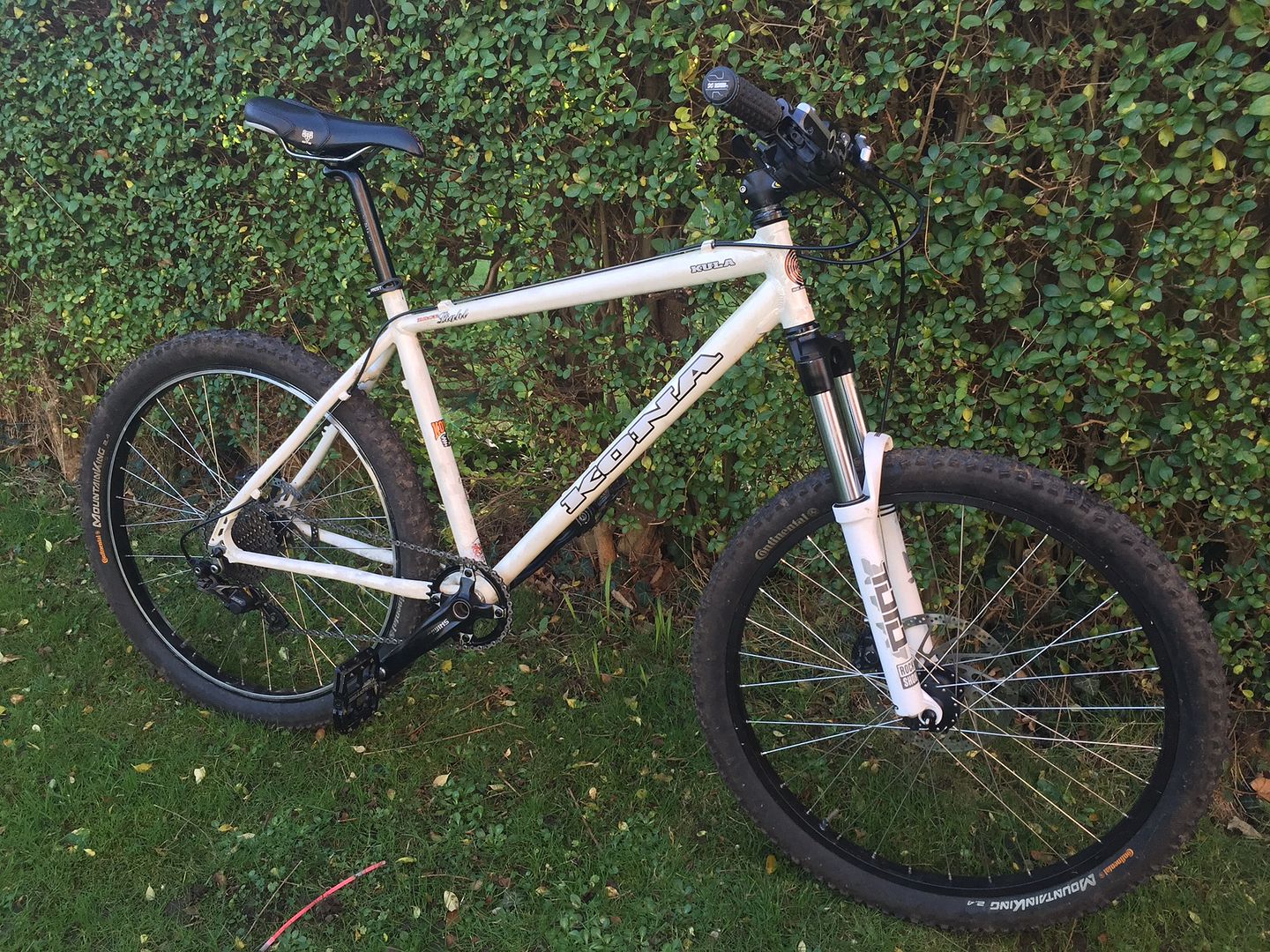

Here are some of the pictures that you sent me for other members to have a go at identifying further, although this does really belong in the post 1998 section.

Yes it has indeed been re-painted; sorry that I didn’t make that clearer in my reply. I merely made reference to the 1995 Kilauea as it seems that this was the “appearance” that was intended by the choice of colour and decals.
At 1.6 kg for a 19” inch frame, it is looking more likely to be Easton Ultralite Race tubing, which was used on the Kula and Kula Deluxe – they were identical frames with a different paint job, while the Deluxe had a slightly higher spec.
As for yours being Scandium, it now looks unlikely. Kona did use Easton Scandium 7000 tubing when they first introduced it in 2000 (originally on the Explosif, then Kula Primo), but by about 2006 this changed to a generic Kona Scandium Tubeset used on the Kula Supreme. I don’t know who produced this later Tubeset.

To be honest.
As a massive Kona fan who's had a few.
As long as it's a Kula, Easton tubing is fine.
Looking at the dropouts and the narrowing seat tube, I'm pretty happy it's a Kula.
