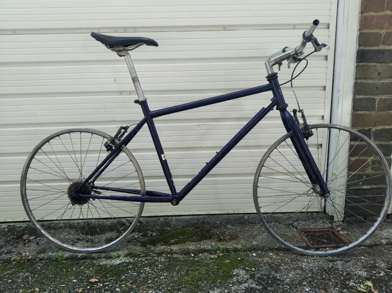

My mid nineties Kona Kiluaea. Can’t remember what year I bought it, hopefully someone here can ID it for me.
Problem is thus: it’s got the original joe Murray headset which was working ok. I removed the headset to replace it but changed my mind and refitted. I removed the bearings, a quick measure suggested they were 5/32
Ordered some new ones but when I re assembled the headset even when tightened to being too stiff to turn the bars there is still play in the lower race.
Either I have fitted the headset wrongly (can’t see I have as the bottom cup is a little rusty on the outside where it was under the original rubber cover) or I have the wrong size bearings.
So questions are:
What year is my Kona?
What size bearings does the Joe Murray headset take.
Answers on a postcard please

Link above suggests 1/4 on bottom race, 5/32 on the top
I’ll let you know how I get on ordering some 1/4 now. Should have paid more attention when I took it apart!

Re the year, if that is the original colour it will be a 1992 Kilauea. It was introduced part way through the year so didn't appear in the 1992 Kona catalogue. In '93 it followed the same 2 tone paint schemes as the rest of the models.
