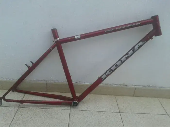

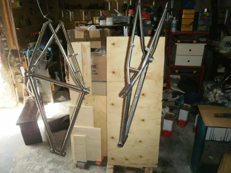

Hi, here is the restoration process of this bike. I choose a kona because was one of the iconic mtb makers of my old school mtb friends group(with marin too). Dispite this is a basic model, i will put much love and will upgrade some components, will customize too in my own style/way. Starting with de paint process.
I will not put all the pics, but only the ones that shows the results of each part of the process.
I will update the post with the other parts of the process, like painting and set up components.

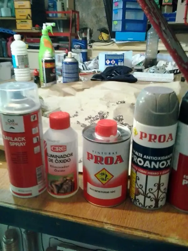

Previously of that process showed, i removed all rust from bottom bracket tube, and the one inside frame with an acid dust remover.

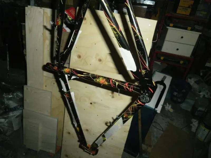

I will choose a new color, a "tuned" color with the idea of model,s name in mind "fire mountain" The base color will be black but tuned with red and yellow.
Something similar to this.
but changing the white over te black, for red and yelow.
I know this is not oem from kona, but i like to be "original", and the design of gt,s is the one i like more in paiting terms. I cannot do it equal but you will imagine the idea.

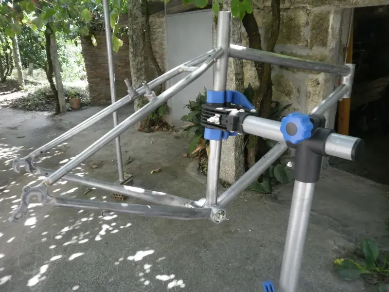

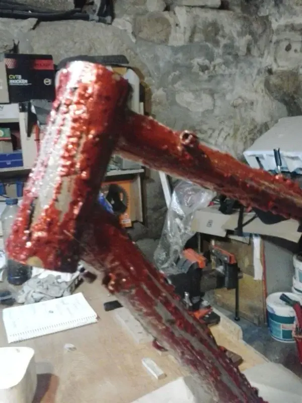

The proces i used is first rust removing, whash the product with high pressure water machine, this removed the product and the small fragments of rust moving inside the tubes , then dry up, then a spry grease aplied to the all inside frame tubes to prevent new rust.
Applied paint remover, then remove all the product and the paint, polished all the frame with this.

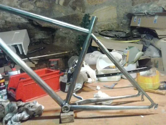

The last cleaning before the painting process will be made with "metallic wool", i dont know how you call, is something like this

This week have started the white primer process with his brother, a Marin team marin frame, previosuly was cleaned.
