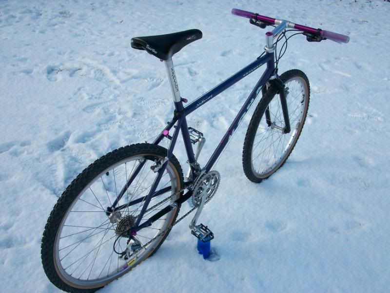

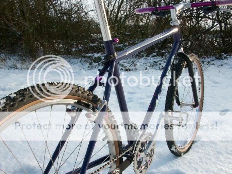

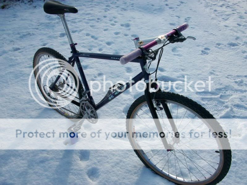

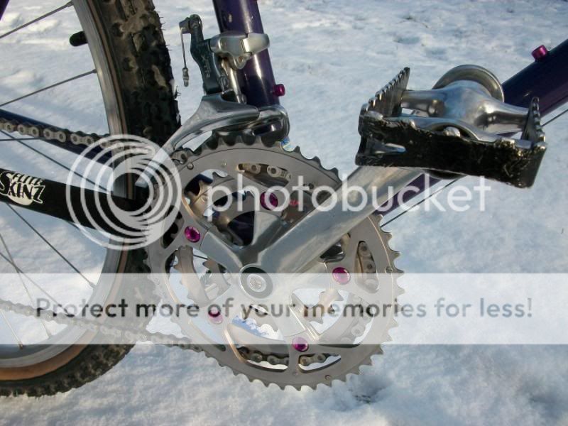

I got this as a frame & fork at the back end of 2008, its been a bit of a long term project.
The frame & forks was advertised on here & after telling the guy i wanted it & asking him for payment details it turns out he lives about a mile away from my house ........... small world.
Ive been collecting bits for it since then & finally got it all together last week.
The paint finish on the frame is original & comes complete with all the battle scars its collected over the years but i repainted the fork as it was well past its best.
Parts rundown ....
Kona Explosif F&F .. original finish

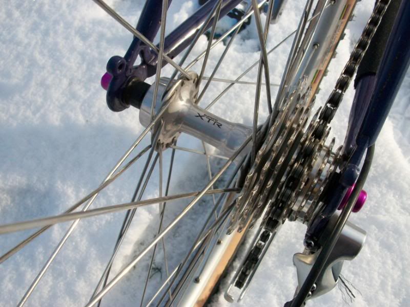

M900 hubs
M900 Cranks
M900 front & rear mech's
M900 brakes & levers
USE bars

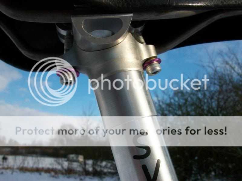

Syncros seat post
Campagnolo pedals
Onza headset
Richey tyres
Rocket Science stem.
Hope you all like it & im looking forward to this summers rides :D

Not the best weather to test it in, but how are you finding it, nippy ?

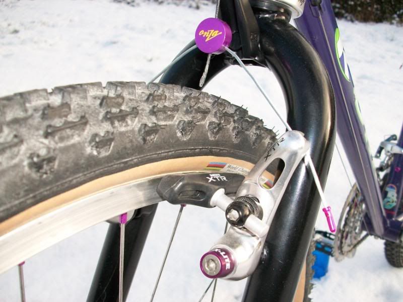

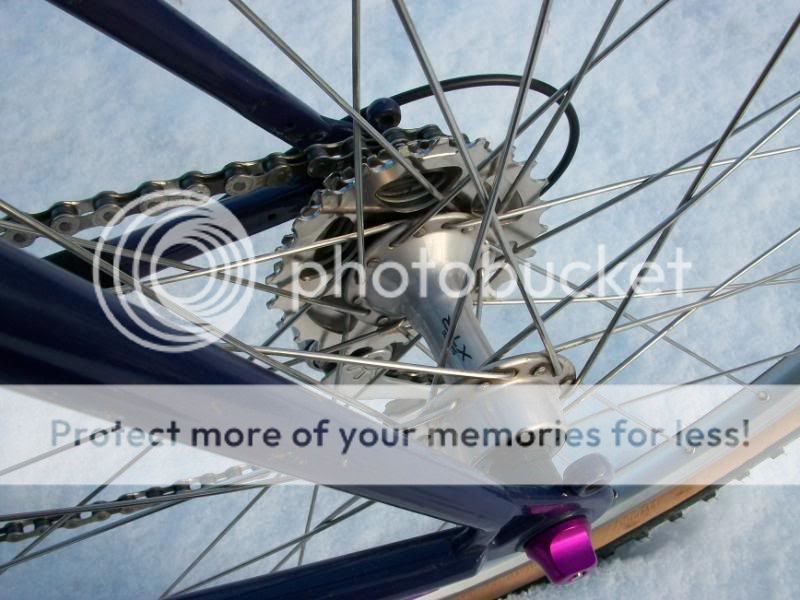

- I would run the rear straddle cable much much lower than that, the short lower profile of the M900 rears means the straddle does run close to the tyre.
(I'd also run the front lower and further out on the pads, but that's just my preference)
RM-395 Rim on the front, can't quite make it out, if so or similar, go find the nearest gritty mud.. shouldn't be to hard looking at the gritted roads and get the pads worn down, can be tricky to get the best angle on them as they angle inwards to the top, let alone the concave surface.
really needs an M900 cassette on there to finish it off ;)
front mech could run a few mm lower but getting picky now..
and bottom ring is out by a rotation, that certain to loose it BotM :shock:

Thank you all for the positive comments & fluffy for your good advice about the rings etc, hadnt noticed that :oops: .
Im pretty new to this & am more used to building BMX's
Ive still got lots of adjustments to do to get it right, there's a frayed gear cable etc & yes i do have some more purple cable ends to put on :D
Also i have a pair of Campag rims to lace the hubs to so its not quite finished yet 8)
