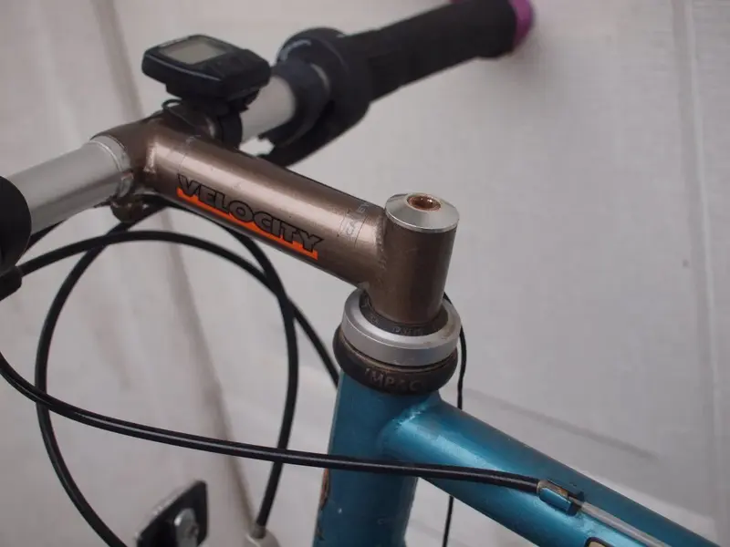

Bumping this older thread as I recently acquired a 1995 Kona Cinder Cone which will become my wife's "gravel" bike. Here's the specs...
https://www.bikepedia.com/quickbike/Bik ... der%20Cone
It needs a shorter, raised stem, which I think can best be accomplished by going with a threadless headset. Of course this gives me the advantage of easily swapping different stems in the future if the original one doesn't quite work out.
Here's a pic of what's on there now. This and most everything else looks original, as it agrees with the specs in the link above.
Thoughts on the best solution?
Re: Re:
Splatter Paint":22hkgzk5 said:
A short, high-rise quill might do the job, without resorting to changing the forks, headset and stem.
Something like this?
https://www.ebay.co.uk/itm/25-4mm-KALLO ... SwnF9Y706w
That could be a possibility, but I think I'd prefer to fully convert over to a fully modular (modern) approach and go with something like this...
https://www.ebay.com/itm/SpeedPark-240m ... SwnHZYiE0b
I'm just not sure if this one ^^^ is to convert from a 1" threaded fork or 1 1/8". It gets confusing with an adapter for someone who's not savvy since a 1" fork measures 7/8" and a 1 1/8" measures 1".
Yeah.... quill to ahead converters :? some have a 22.2 mm quill (7/8") , then a shim taking it out to 25.4 mm (1") to fit a 1 1/8" headset (31.8 mm). Confused?!
So you now have a quill with a shim, with an ahead stem fitted onto it! Inevitably this will be heavy, I would also refrain from serious off-road with it. The one you selected does appear to be for 1 1/8" headsets though.
SP
Yea, I wouldn't use a shim - just get the right size (1", in this case), and up top would be 28.6mm (1 1/8"). 31.8mm is 1 1/4", which is the "new standard" for handlebar diameter (the other end of the stem).
My concern with the one I linked above is the length, at 24 cm. Although my wife prefers something sitting up a little higher, I don't like the idea so much of the extra leverage that'll now be put on that part vs. the more typical one at 16 cm. And who knows if they've taken that into account with a stronger tube.
