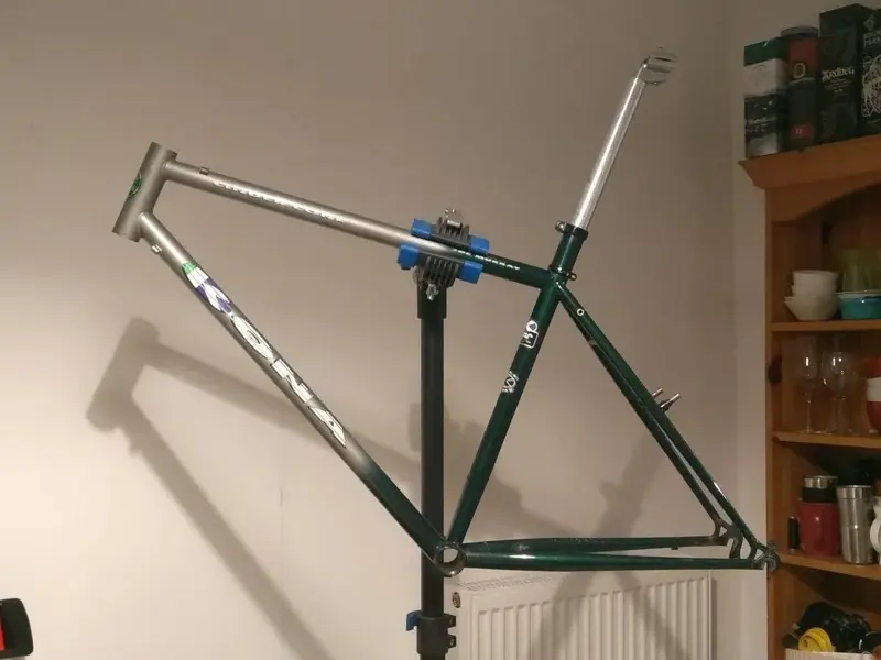

1993 Cinder Cone frame. It's got patina but I like that and it won't be getting new paint or decals.
First daft Q: I have a 410 A to C triple butted P2 that I may put on. Too long. But I also have a 110 mm stem (shorter than original for 19" frame). Thinking that might sharpen up the steering, counter-acting longer fork. My hope is that this set-up might be easier on my ancient carcass without bug___ing up the handing too badly. Any thoughts? IMG_20231206_214914641 (2).webp
My daughter runs a 92 Kilauea 19” with 410 p2 forks on it. No issues to mention. It’s fitted with a 100mm stem. I’ve been collecting parts for some time now though and next spring I’ll be returning it to standard 390 tb forks with a short velocity stem and impact headset. I’m not expecting a huge difference but it will be more original.

Dug out the P2. Yay! Steerer is right length. Probably should have checked before. O well. All's good etc.

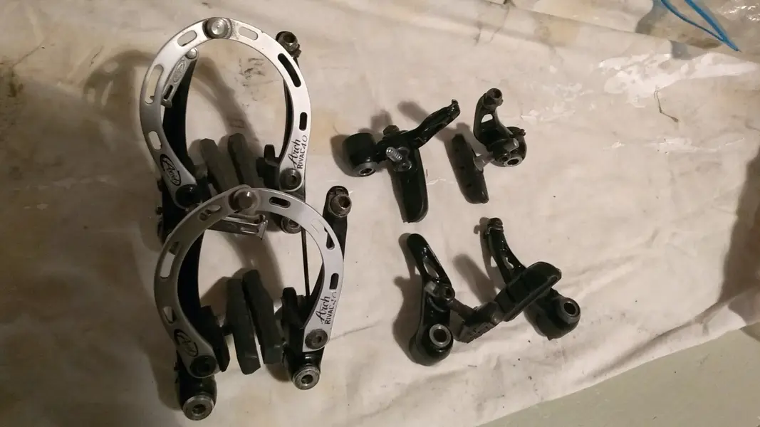

Pondering brakes. Black LX cantis will go with the black LX hubs. But slightly tempted by the Arch Rivals....but that means messing about with problem solvers etc. Cantis neater I think and a bit lighter. But, but, but...
Time for a wee Ardbeg for for inspiration.

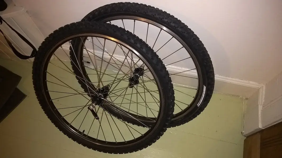

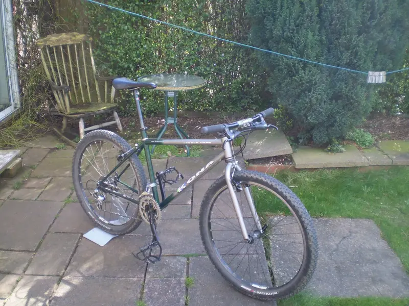

Forks are suspension corrected so too long for the frame really, but the aim is to run them with a short stem. Unfortunately I don’t have a short ’93 stem (silver grey) so faked it up with an older 100 mm stem. Unfortunately it’s black. Doesn't look great. But the hubs are black too. Beer. Dug out some black Ritchey bars. And I’ve got those black cantis and some nice black Onza bar ends. Stealth black theme maybe? Let the frame shine?
Nice. Looks purposeful and very much for riding.
I seem to remember when you got that frame you were wondering how it would ride compared with your Kilauea. Is that right? Any thoughts? I was really after a Kilauea but hard to find. I think I'd had taken fewer liberties with the build if I had found one!
Mocked up the bike with a grey Race Light stem (1996 I think) and silver Race Light bars but it looked terrible combined with the black stem. So, it's black theme for bars and controls. And brakes. Black LX cantis.

The FIR rims are a very dark green. Hard to get on photos. May try in daylight.
