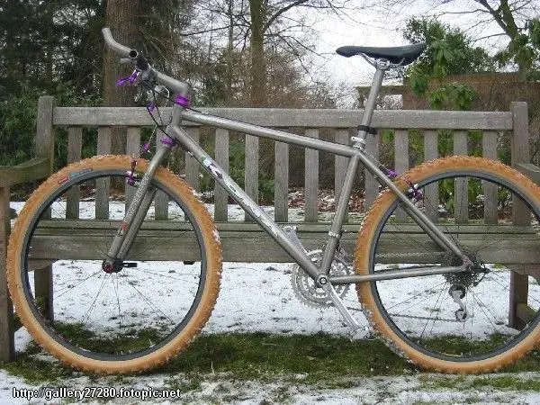

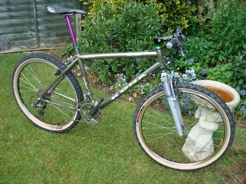

There seem to be two variations of 93 Hei Hei - which of these does yours look like? [Note length of seat tube extension above top tube and bullet ends on stays.]
My Hei Hei is a '93 model which looks like the top picture (bullet dropouts) and I'm going to run XTR Vs on it.
