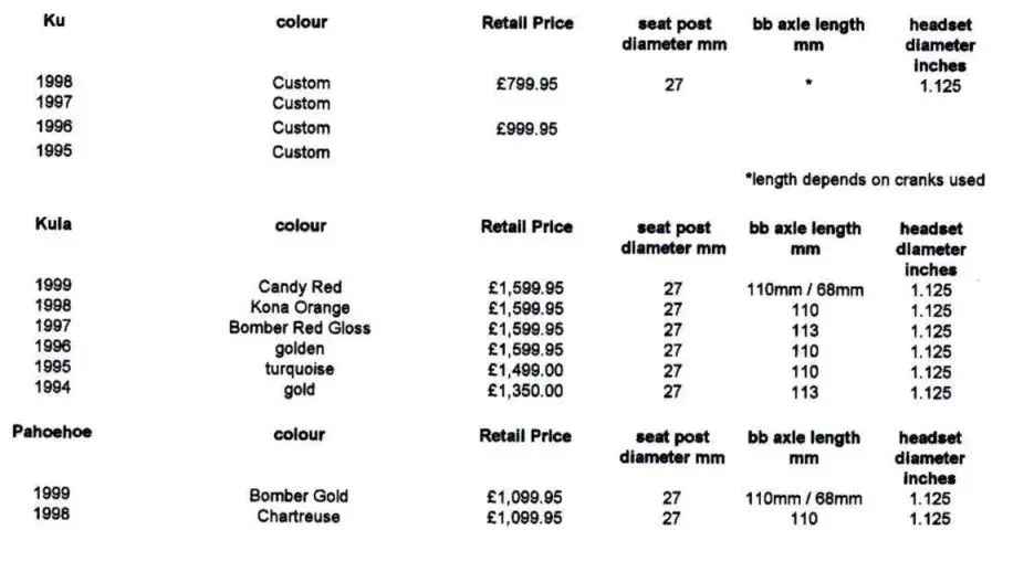

Hi Guys & Gurus. Anyone out there know definitively the diameter of a seatpost on a 96 Kona Kula?
So far I've read what seems like 1/2 doz saying 27mm's and 1/2 doz at 27.2 mm's?

A 1996 Kona Kula requires a 27.0mm Seatpost.
A 27.2mm will not fit, unless the Seatpost is way out of tolerance and undersized, which I have seen on some less than best quality versions.
As Al has pointed out, the bike in the link is a 1996 Kona AA, which I believe requires the same sized Seatpost.

Well bantamsuper, it would appear that we haven’t really given you the desired & definitive answer that you need. :oops:
Mmm, well here’s my take on it. Although I don’t actually own a 1996 Kula, I do own a 1996 Ku that has a Main Frame constructed from the same tubing as the Kula - Easton ProGram Elite.
My Ku has had four different 27.0mm posts successfully fitted in the frame – a Ritchey S12 WCS , a Kona Tahoma, a PZ Racing C3MB and a USE Alien that I won on e-bay last week. 8)
All these posts are fairly accurate when measured with my digital Vernier – circa 26.95 to 26.98.
Other Kula frames that I own also require a 27.0mm post, i.e. my 2000 and my 2001, and these have had most of the posts listed above used in them.
Al, I gave your comments some considerable thought. For a while I was wondering if the 1997 frame that used your 27.0mm was a Steel frame, which would be more forgiving than an Aluminium frame on an undersized post?
Then I just remembered something that I heard some time ago….. As 27.0mm posts are deemed to be rarer than 27.2mm, some riders have had a 27.0mm internal Seat Tube reamed out to accept the more common 27.2mm Post. Maybe that has happened to yours?
