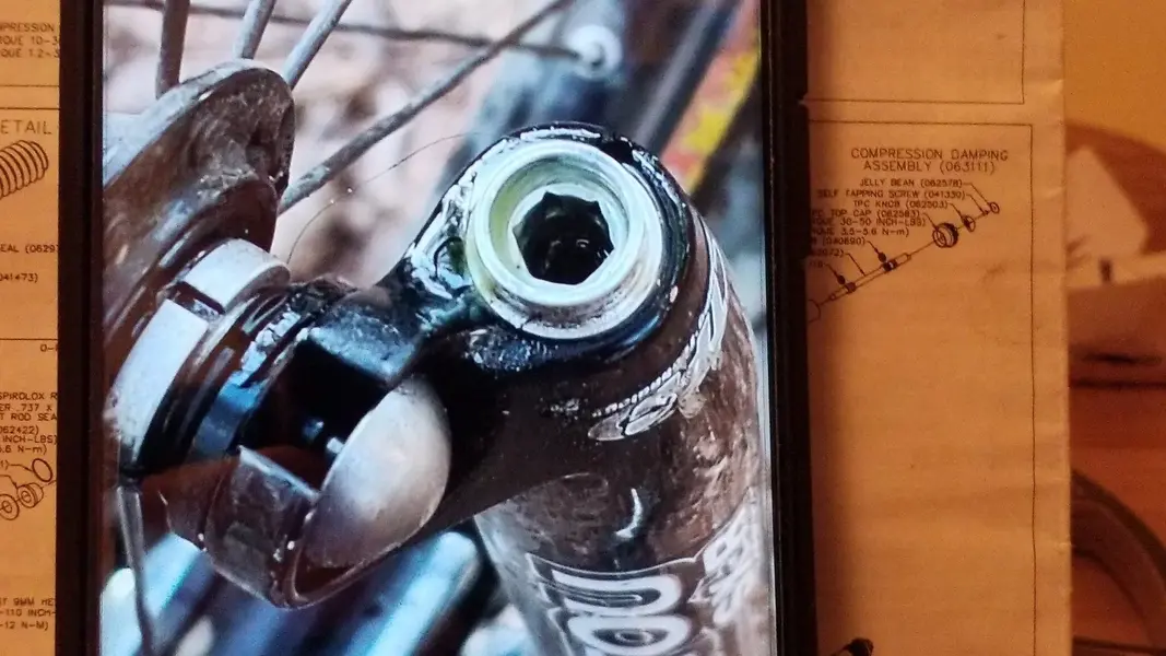

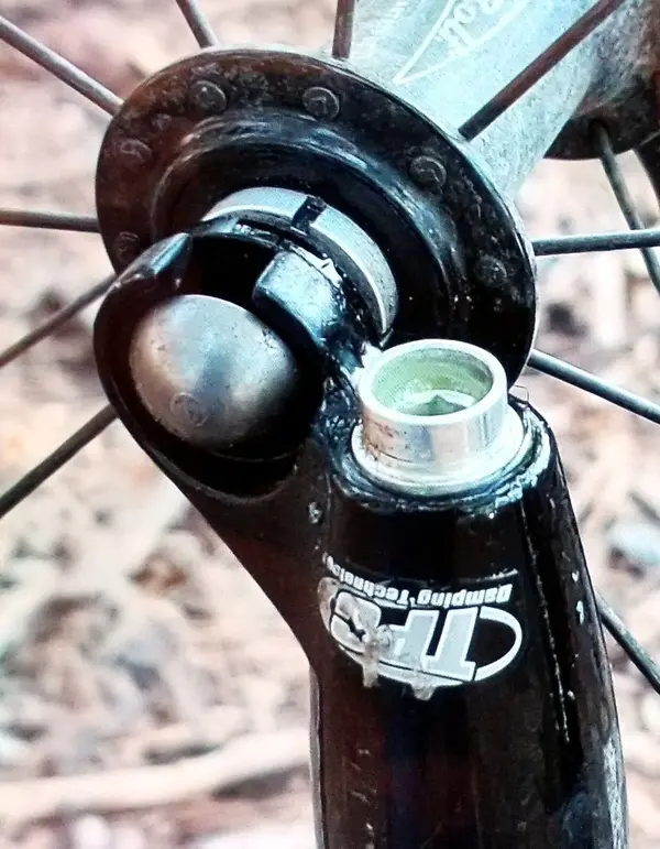

I'm a weekend cyclist and rarely venture into mtb park trails. However yesterday I went to the Forest trails in Bracknell, UK for a birthday group ride out and after a particular rough downhill section when the suspension definitely bottomed out several times I noticed that there was blue oil running out of the right fork lower onto the ground.

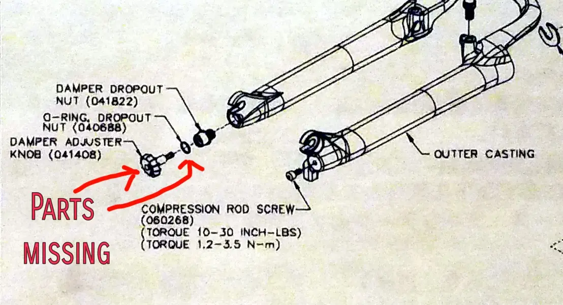

The plastic Damper Adjuster Knob which was located on the bottom of the right fork and its O-Ring Dropout Nut have vanished.
See attached photos and schematic plans of the forks from the Manitou 2001 SX range manual. Could this have been forced off by internal pressure as the forks bottomed out?
I'm guessing that without the damper adjustment knob and the dropout o ring there was nothing to prevent the oil from leaking.
Crucially the hollow Damper Dropout Nut is still in place so I was able to get back to the car.
The forks still operate but are a bit jerkier. I've noticed that if I lift the front there is a clunk from the forks. Is this because there is no oil in the fork any more?
Does anyone know if the forks can be repaired? Or of a supplier of the parts?
Could a repair be as simple as replacing the oil then inserting the 2 missing pieces?

I know. Old thread, but in case, you’re still listening, oil leak from the bottom of the damper probably means you need a new loc out rod seal. 062392. enduroforkseals in the US had this. Possibly also need the 3/4 x 7/8 oring on the cap, FWIW my 2000 Mars C fit a 15/16 x 17/16 oring better even though the manual specified the 3/4 x 7/8. (Inch measurements of ID x OD). Should replace the small o-rings on the rebound shaft while you’re at it. Hopefully Shouldn’t leak from the rebound adjuster needle after that.
