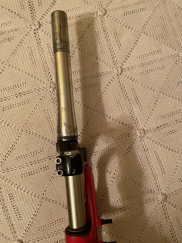

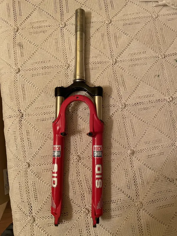

My Attitude 96 came like yours, with a SID Hydra, but with the crown adapted from a Judy (it had to be common at that time, to adapt forks for these frames with "special" steering.
BTW, what I'm going to do is get a JUDY from those years, and add the crown that my SID had, I mean, reverse the process ..
Here you have pics of my fork
The SID Hydra, not period-corrrect but a great color-match I guess.
How did you work out the cable-hanger, since SID's came without?
I Sourced some cheap blue eBay-thingy to match the fork somewhat.
