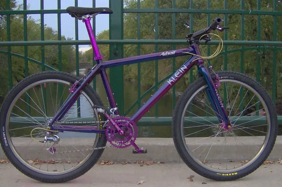

Here's another boring Klein. Just recently finished with new headset bearings and press-in bottom bracket.
The kit:
Stem: MC3 120mm
Seatpost: Thomson
Hubs: Machine Tech Powerclaw
Seatpost binder: Ringle
Handlebar: Answer Hyperlite
Brakes: Machine Tech zero-flex cantilever
Levers: Tech Lite Cantilever
Shifters: Shimano XT thumbies
Front mech: XTR M900
Rear mech: XTR M900
BB: Phil Wood press-in
Rims: Mavic 217 SUP bronze
Crankset: Cook RSR 171mm
Chainrings: Cook 46t, Kooka 34t, Middleburn 24t
pedals: shimano clipless (soon to be replaced by xt flats)
Chain: SRAM 8 speed
Cassette: SRAM 8 speed
Skewers: Ringle holey gold
Saddle: Terry Fly Ti

I thought the colour had gone wrong on my Mac. Suddenly it went all purple :shock: :lol: :lol: :lol: Love the late Klein Aroit.
hmm, nice bike and i love that color :)
is the Thomson post original or custom anodized? i remember that they had a purple one in 96 but it did not go into production.
is that by any chance the Strata that recently went on ebay? just curious...

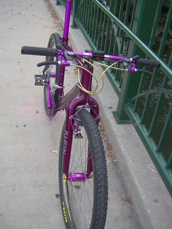

the only thing i would do is to cut the cable housings shorter and re-route the cables. left shifter into right inlet and vice versa. the inner cables then cross each other inside the down tube. gives a much cleaner look and the cables dont rub on the head tube.
