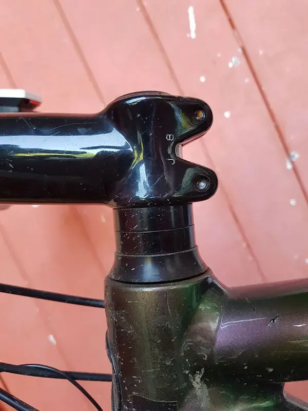

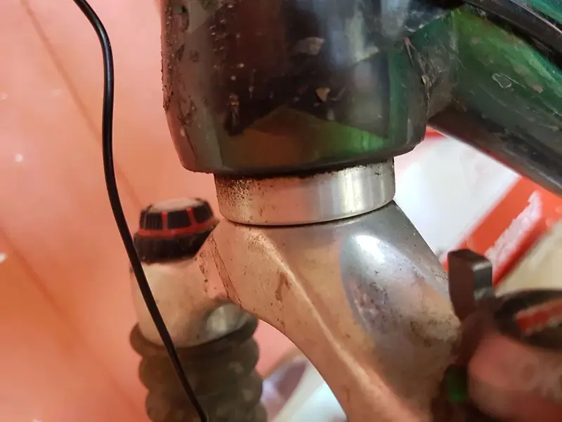

My 1999 Klein Adroit Race is still running the original Manitou SX-R fork on the Aheadset MC bearings.
Does anyone know what the bearings are in this model? It says MC3 on the stem but from research the bearings are MC2
The fork is finally giving out so I need to look at options.
Anyone installed and used the Reset Racing replacement headset or a conversion kit? Conversion kits seem to have limitations from what I can gather.
1 1/8 straight steerer tubes are now old in design and I've got no hope of V brake mounts so I was thinking of putting a eXotic Rigid Carbon Fork.
Any help / thoughts / ideas appreciated.

Hi there,
MC3 is really just the branding on the stem. The frame uses the same bearings as MC2 so plenty of options to purchase them if required like from Jon at kleinspainted.com.

I've no clue about the fork fitting, but with all the new fangled tapered fork steerers these days, does nothing modern fit?
Don't think so...
I might be wrong but the Klein steerer was something like 1.5" to 1.3" tapered. The new all taper to 1 1/8" (although I've not got a bike newer than 2002 so happy to be wrong!)
A good workshop could machine a Klein steerer that could fit to a modern fork, just depends on time/money and desire I guess....
If 1.5 will fit lower, can't something fit in the upper headset to shim the gap, or replace the compression washer for one that fits?

Since I posted this I got in touch with Jon at kleinspainted.com. He does a pair of inserts which allow you to use the existing bearings and fit a 1 1/8 straight steerer tube fork.
I contacted Reset Racing and asked them if they have plans to make a headset that will take a modern tapered fork. They don't at the moment.
The Reset headset protrudes top and bottom of the headtube.
I'm gonna fit a rigid carbon fork and look at getting a new bike later in the year. I've been putting this job off for about 15 years!
