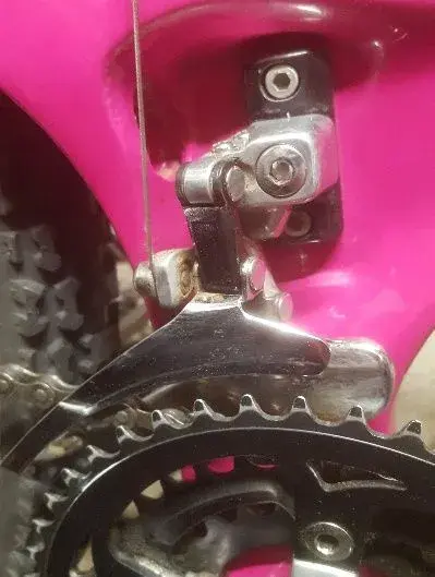

For the chainset you probably just need a different bottom bracket with a different length axle. I have a similar issue with my current Kirk in that the bottom bracket axle is too short for the chainset so the front mech fouls on the frame before it'll drop the chain onto the granny ring :facepalm: maybe I'll get around to fitting the right length bottom bracket some day :lol:
This is the front mech on my current Kirk...

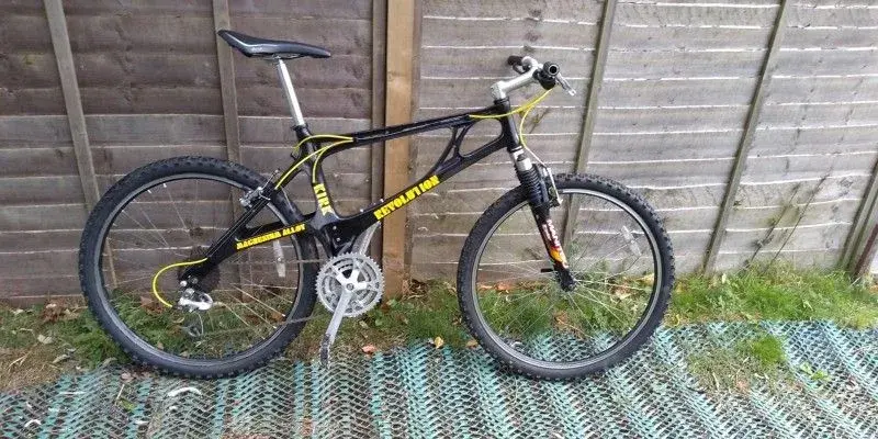

Thanks I have the bracket and will be able to make something that fits when I get a chance. I have thrown it together with random parts as the yellow cable arrived quite pleased with the look. Looking forward to first ride after work

Well I am ummm err impressed an amazing ride, very very as you say different.
