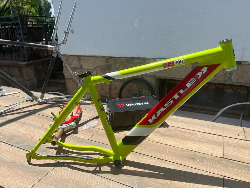

Then we move on to the "heaviest" part.
The pedals must be stripped and sanded before painting them.
1st photo: Stripped above, sanded below.
2nd photo: Primer.
3rd photo: The first white coat, which will give it shine and lighten the green.

Well, then I moved on to painting in green.
I want to point out here that even though I looked for a similar RAL, I couldn't find it.
I know who paints for Pramac, whose corporate color is very similar in apple green and red, but they didn't know when they were going to paint in that color again, and I certainly wasn't going to use 1 liter of paint to throw 900 cc in the trash.
So I looked for the closest match (that's why I paint in white beforehand to clarify) and decided to do it myself.
After painting, I had to varnish. I've already mentioned that I'm terrible at it, I don't know why, but I'm terrified of varnishing. But I was even more terrified of doing the entire assembly without varnishing first... not to mention trying the pedals without varnishing them.
In the end, it didn't turn out so badly, as you can see in the second photo.

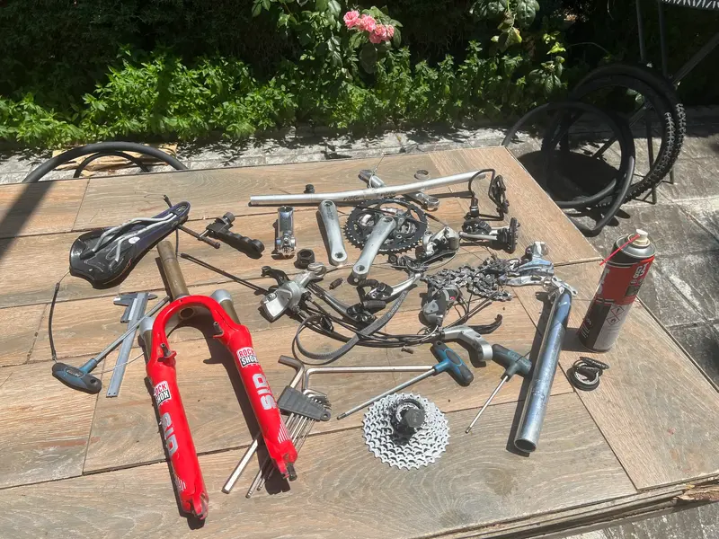

Okay, now it's time to get serious about riding.
The fork is killing me. Being a 2000 model, I think the SID would be the best.
I've had a SID XC for years and it works well, haha. It's logical, it's barely used, even the vinyl is spotless.
On the other hand, I thought the original Race was a mess, which is why I considered the XC. When I blew air into it, it stood up tall, and it's been like that for a month, without losing a single mm. To top it off, the rebound works...
But like I said, I don't know much about Rock Shox and I don't know which model would be better.
I've compared them, and interestingly, although the overall height is similar, the XC's legs are 24 mm taller, although the bridge is barely 1 cm higher. The Race's crown is infinitely prettier than the XC's (super tacky), although I like the XC's bridge better.
I think the XC is from '99...no idea, I don't know anything about SID.
So in the end, the scales ruled. The Race weighs an incredible 1.19 kg with the spider and everything! And while it's true that the XC has a couple of cm longer head tube, its 1.4 kg length is pretty average, nothing remarkable.
So I'm using the Race. It's also the original.
