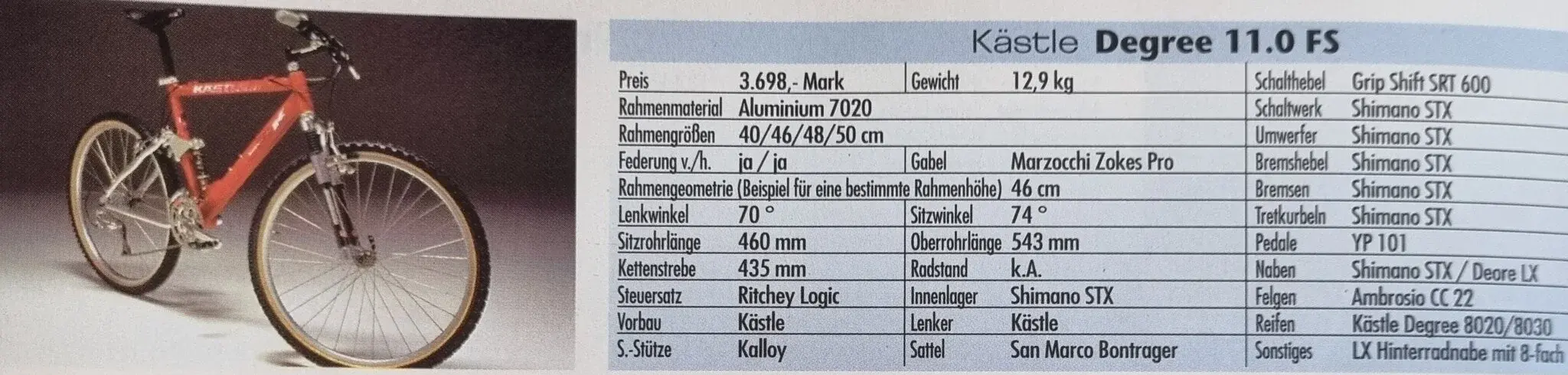

It's from 1996, as there isn't a lot of documenation about Kästle I'm happy to share a few bits
The test result (picture from Google translator) isn't great, but this is only a matter of the a bit cheaper components in particular the suspension Fork to provide an attractive price
The higher equiped Kästle FS had all Marzocchi MX or DH forks. I would give it a try with a better fork, maybe even up to an early Bomber...

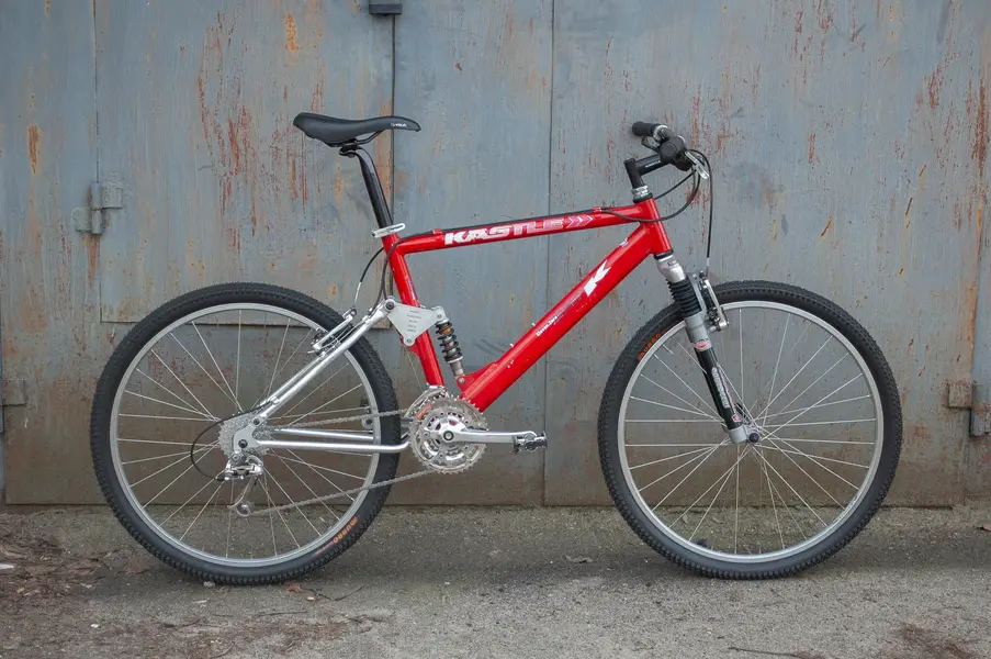

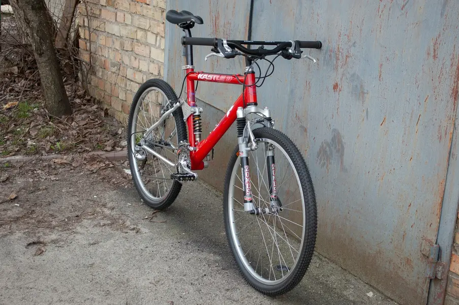

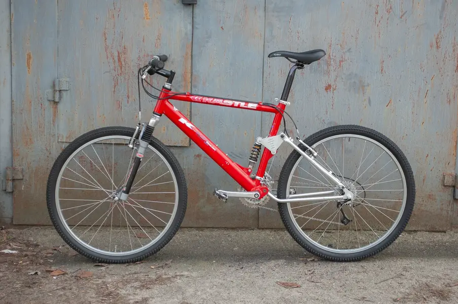

Kastle Degree 11.0 FS
Bike specs:
- 16" alu frame
- Marzocchi Zokes Pro fork
- 26" wheels
- Shimano STX 3x8 speed transmission
- Shimano Deore XT brake system
- 36x24 bottom bracket

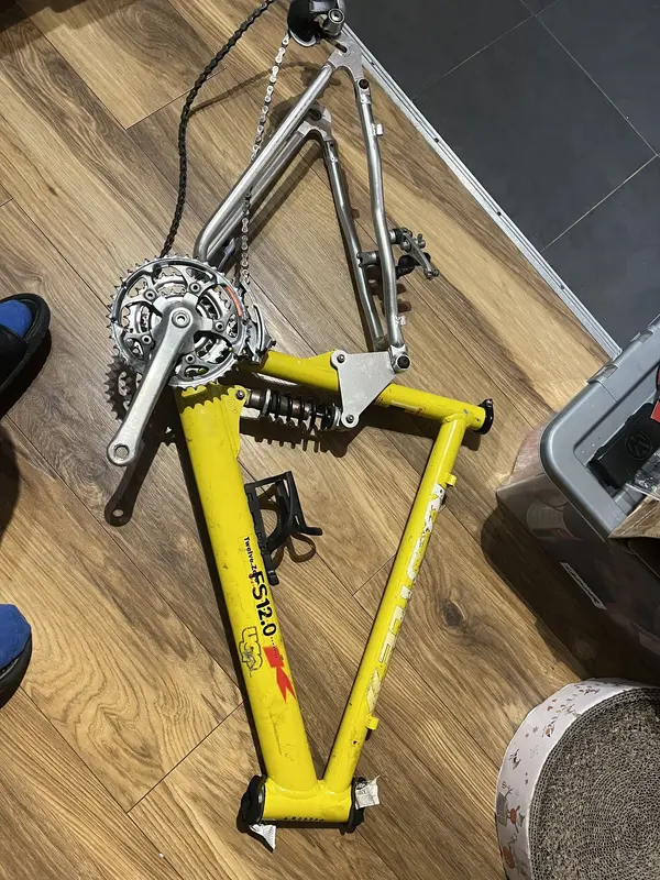

Hi nice job:) I just got Kastle fs 12.0 (just frame) I wondering what was the original fork, wheels etc. If any one can help? Thank you

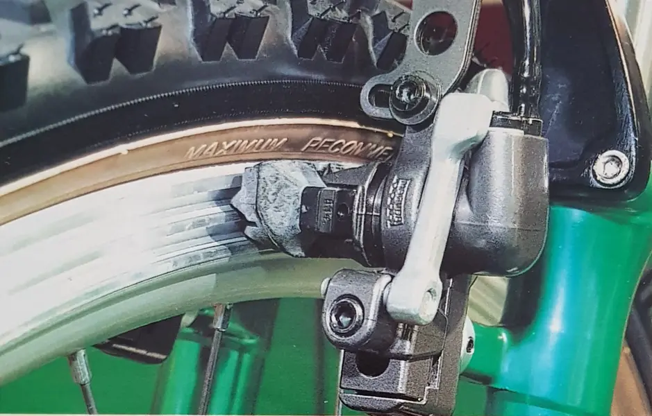

As mentioned at the ad, the bike came with the interesting brake system.
Maguras with specific Kästle brake pads with tooth, and specific rims fitting to this.
I've never used something like this, but the idea was mostly to increase the surface between the pads and the rims.
In particular this will be hard to get somewhere these days.
