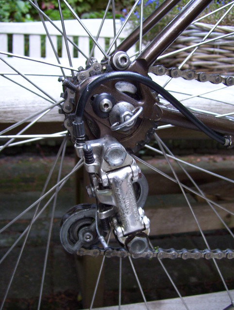

Pictured you see a Nuovo Gran Sport mech with older Tacx wheels fitted. I think they have a larger diameter than the originals, but apparantly it works fine. Tacx wheels come with spacers for the width. Most replacement pulleys I bought came with spacers.
The original bolts are replaced by allen bolts, possibly a pragmatic choice because the derailleur is fitted on a bike for making journeys with. A to me unique feature is the adjuster barrel on the back: 1st time I see such on a N-GS mech. Finally distinctive is the Portacatena mechanism for holding your chain tensioned with wheel removed.
Back to topic: Bottom line is I think you can't go wrong easily. What matters is how accurate/original you want to keep your bike.
