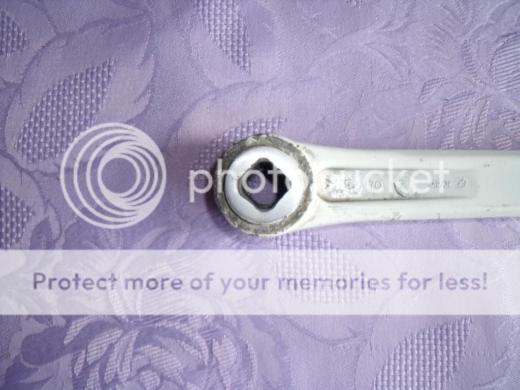

Anyway, I had a little bit of this stuff left and thought about trying it on something else - a wobbly Sakae SA crank arm. This thing was ruined due to some numpty riding around with a loose crank arm - not me BTW. This stuff sets really hard so I thought it had to be better than a coke can shim.
After keying the affected area of the crank arm, I greased the tapered axle lightly before applying the JB weld to the crank arm before sliding it on and tightening. JB Weld can be runny so I left the bb in a frame and placed it on the floor so gravity would take it's course.
I knew I would be removing my crank to inspect it but you could miss this step out if you were fitting the crank to the bike it came off etc.
Mine came off the axle clean and it has filled the gaps perfectly - I have no idea how long this bodge will hold up but it has to be better than a shim...
My pics aren't brilliant but they will give you a rough idea of what the JB Weld has achieved. I need to trawl through Photobucket to find a before picture - back soon...
I have the drive arm to match and really didn't want to chuck this arm away so I thought it had to be worth a shot...

I mentioned coke can shims earlier but this product has replicated the exact shape of the BB axle which must be better. The biggest question mark is regarding how hard this stuff sets and will it compress or not.

Most of the deformation was at rear of the tapered interface. The machined interface was generally good at the narrow end/front of crank so this product just built up that area. I
I had the JB weld sitting there and a duff crank arm and thought, why not...
