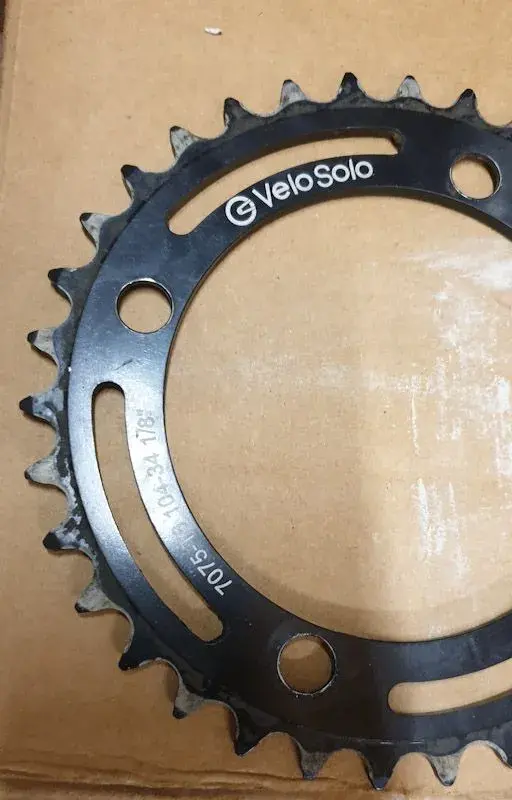

Is this a narrow/wide ring?
ishaw
GT Fan
Found this in my stash, think it might be a narrow wide and will save me having to buy one. Is it?
Hard to tell for sure from here, are the teeth narrow and wide?
Velosolo don’t (afaik) do narrow wide tings. It’s just where the inner plates have worn more anodising off innit?
Looks to be just like the usual wear pattern from the inner link pairs of the chain. NW rings have very obvious alternating thick/thin teeth.
Also, it's an even tooth count AND a single speed/track ring, so that inner/outer wear pattern will be very very noticeable.
No. It's not.
(Does anyone even make 1/8" narrow/wides?)
Cheers. Consensus suggests not. It was on a 1x drivetrain I bought, just wondered if.....
Oh well, I'll run with the ethirteen with guide ring as these are narrow wide.
No need is there? Can't run an 1/8" chain with a derailleur so chain tension would be set by either horizontal/sliding/rocker dropouts, ebb, or sprung tensioner.
