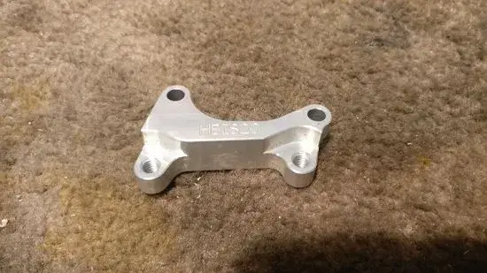

Am I right in thinking that without an adapter on the front or rear, the largest discs I could fit to IS tabs (the brakes have IS tabs as well) are 160mm on the front and 140mm on the rear?
If you are not using any adapters yes the disc size is linked to the caliper size but there are IS-IS+20mm (and +40) adapters available if you did want to increase the rotor size.
Something like this, from A2Z or hope allows you to increase the size on IS frame/fork and IS caliper.
