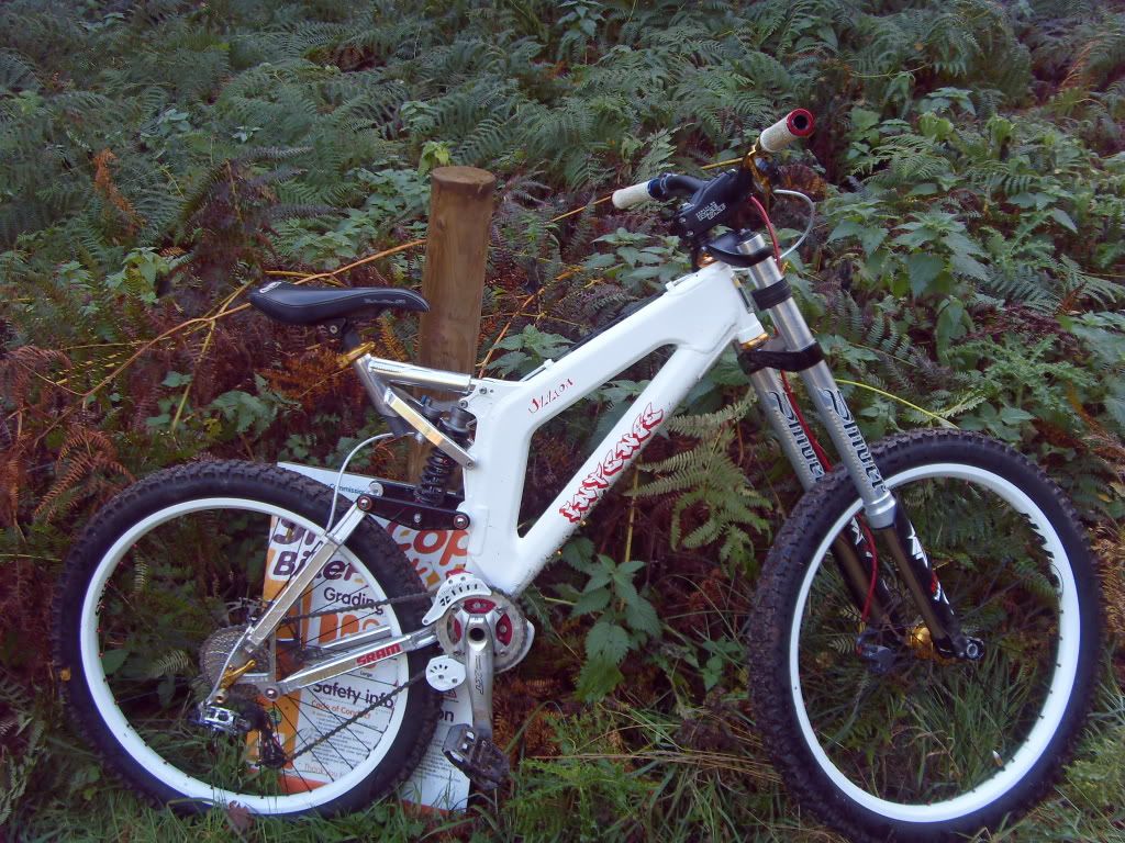

I have my intense uzzi dh which I am running a single ring on the crank
But want to put a front mech in
I have tried putting a bb bracket front mech in but the derailer just keeps rubbing the arm on the crank and its still not over far enough to keep the chain on the ring I have put 2 spacers in there
I am now thinking that this frame is not designed for a front mech
This is the bike
Cheers Steve
[/img]
I have gave this bike to my girlfriends brother who don't really need it for downhill but would like more gears for at least trying to get uphill on it
Now I have changed the front forks as well

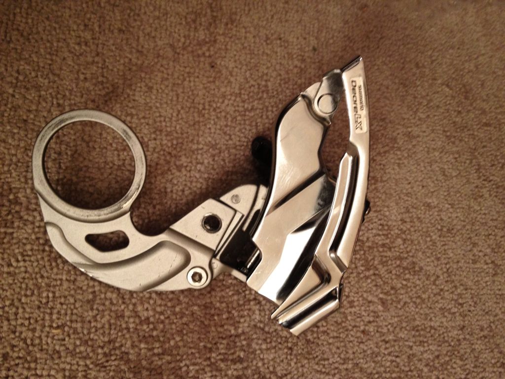

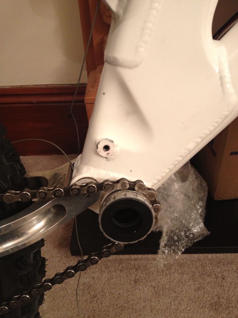

You could run a Shimano E-Type front der. You'd need to replace the bottom bracket with an E version as well. Does it have the I.S. mounting holes on the frame for the chain guide? the plate of the derailleur will bolt right to it.
The correct BB has different cups that retains the proper chainline when it's spaced out by the derailleur mounting bracket.
