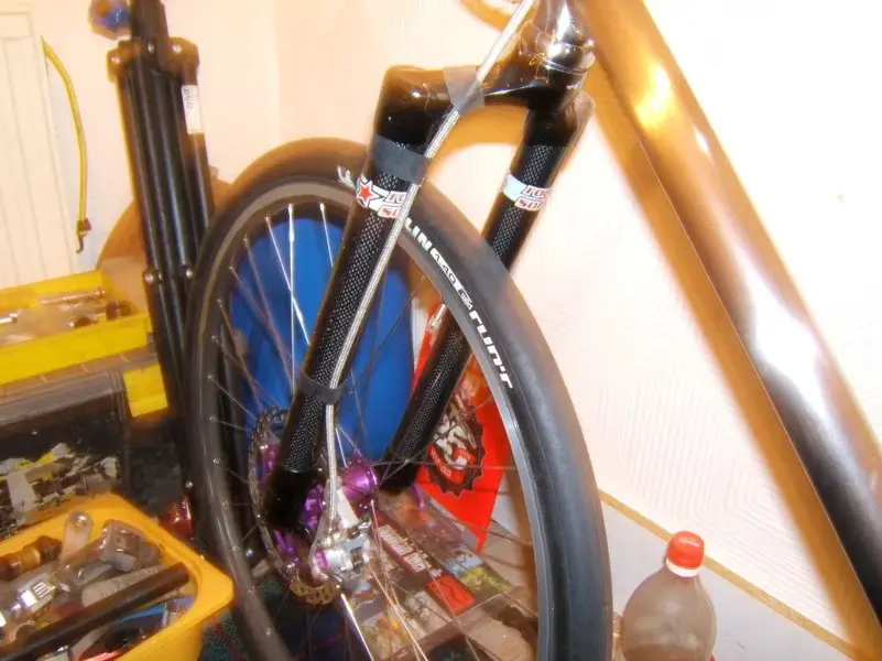

I route it up the back of the leg and along the top- pic.
Not that tidy being just slices of inner tube but it holds and directs better than zippies. :)
Looks ok to me buddy!
