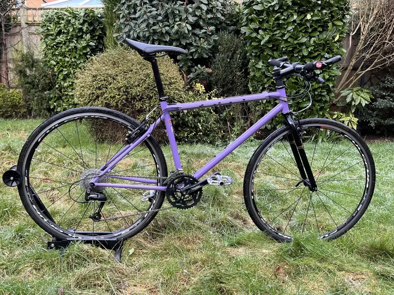

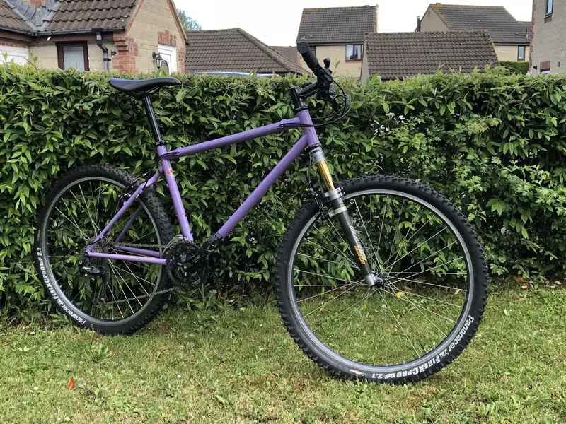

Mine (‘96 853) in its previous (26” and some bounce) and current guises (700c and no bounce). It came to me in “Milka” mauve. And yes, I know the lawn needs seeing to in the last photo.

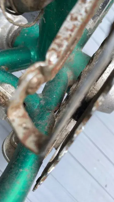

Sooo, it looked good but looks can be deceiving. Previous owner was clearly not smart and fitted a crappy chainset and a BB that was too short, causing the granny ring to eat the chain stay.
So if I take this on, I'd need a repair doing. I assume the entire stay would need replacing, then I'd be looking at a repaint too.
Any advice on repairs and whether it would be worth it?
Argos Racing in Bristol May be worth a call to see the viability of a repair; they are fantastic at frame restorations
It'll certainly cost more to repair than it's worth so it depends how much you want one I guess?
I'd probably be contacting the seller for a refund myself.
