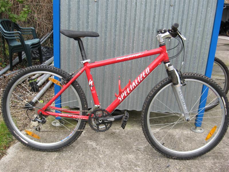

Got one myself, currently for sale though
Has a good few original parts on it and if you were interested could split if it helps you out

Mine's a 19" Blue and Silver frame, and I think it might be a '99 thinking about it
Actually, your bike would be nice for my girlfriend - is there any chance you could send it to Bristol?
