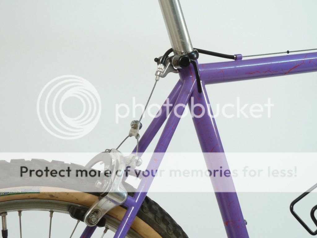

From the beginning, I had planned to repaint the black areas as matching as possible. Talking to my vintage (-car and -motorbike) engaged friends, I got told that a perfect colour match would be nearly impossible. I also had my own bad results paying someone for a non-matching stem. And a whole complete repaint never was a topic for me, since more than 3/4 are in nice original condition. Inspired by Carsten and his do-it-yourself-threads, I decided to try it, having done painting small parts and some touch-ups before.
Removing the black with chemicals was easy, after this came sanding and polishing:
First try with acrylic colour spray, not so happy with the result. It looked more promising with the colour card than in reality.
So, colour off again (using acetone, it didn't hurt the original colour). Next colour mix looked better.
A closer (possible to get) match I have not found yet, also the difference is very small, so I decided to stay with this colour for the moment.

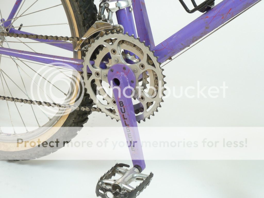

I remembered I had one beaten and rusty set of Bullyeye cranks laying around. I liked the idea of colour-matching them.
After numerous layers of clear paint, the next step was getting the splatter done. Asking Scot Nicol did not help (yet), so I did some experiments. Best results showed up using a very thin stiff plastic tube (1mm) that gets flooded sticking it inside the colour can and is then flipped with your hand. Hard to hit a specific spot, it always goes where you don't expect it, but the style had something in common with the original Ibis splatter.
Lots of polishing (also inbetween) later, I got this result:

Cranks came out fine, rear mech is a XT with 6400 cage (with relocated spring hole).
