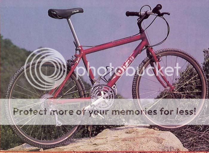

ok so i have a 1988 cannondale but this is the one i always wanted..so what do i need on top of what i already have? obviously need a frame and looks like a stem and bar,think i have pretty much everything else.can anyone help with a frame??
here is what i have at the mo...and no,the wheels are not different sizes lol
hi
was the pic a production cannondale? i have a couple of old cannondales, looks like a 6 speed suntour freewheel, rm20's rims the cranks are obviously xt's like you already have. diacombe 990 rear brake. specialized groundcontrol tyres. original cannondale stem.
that is probably a beast of the east with the higher BB.
i'd tend to try to find a nitto bar and suntour xc post and stem.
your bike is mint already...
i can understand the memory kicking into action and wanting to get that bike you can still smell in the shop. i have just completed a 91 khs montana team in the same vein.
