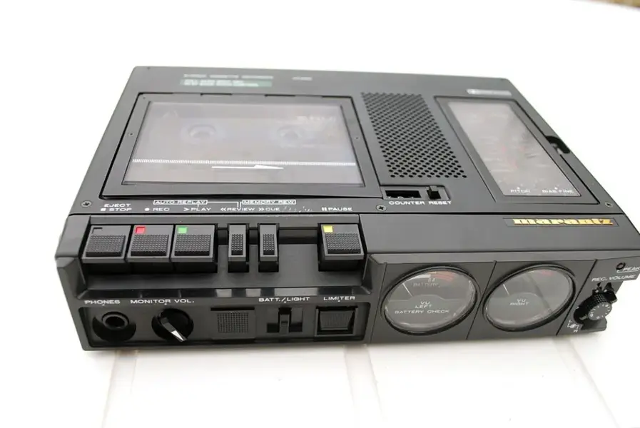

Marantz CP-230

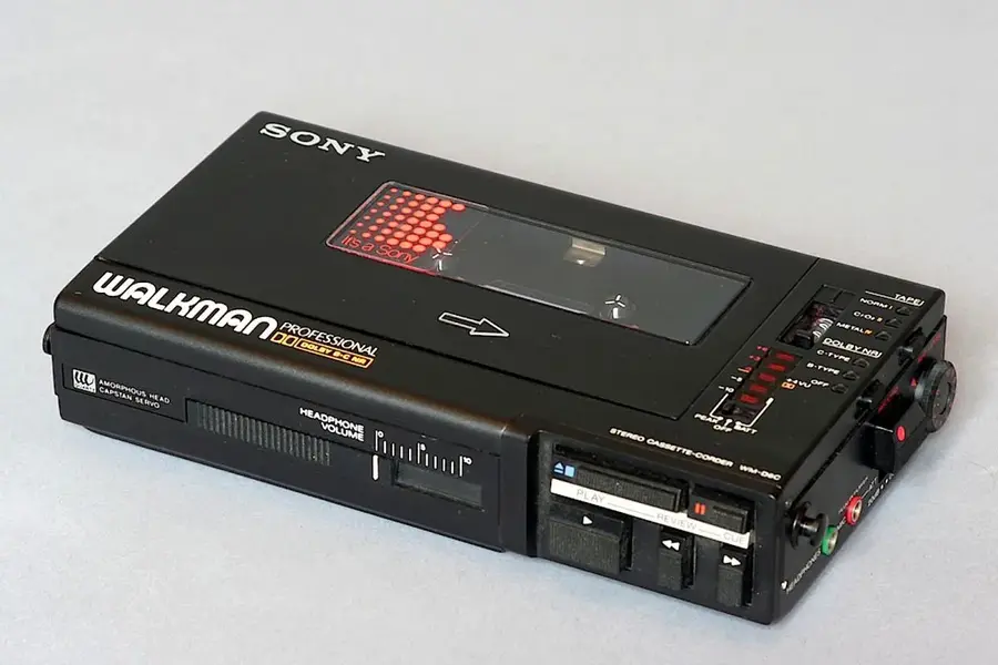

You cant have my Walkman pro though.

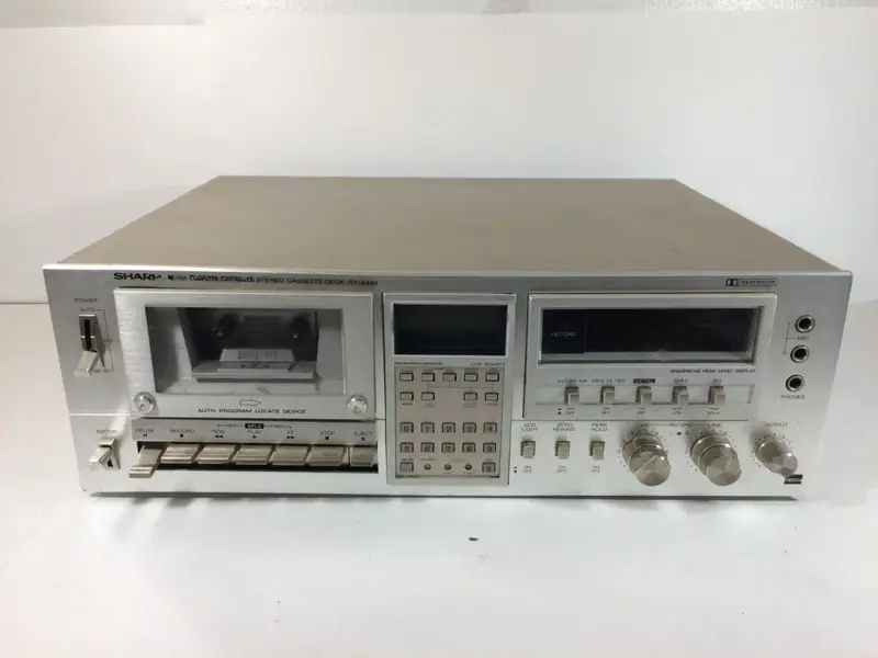

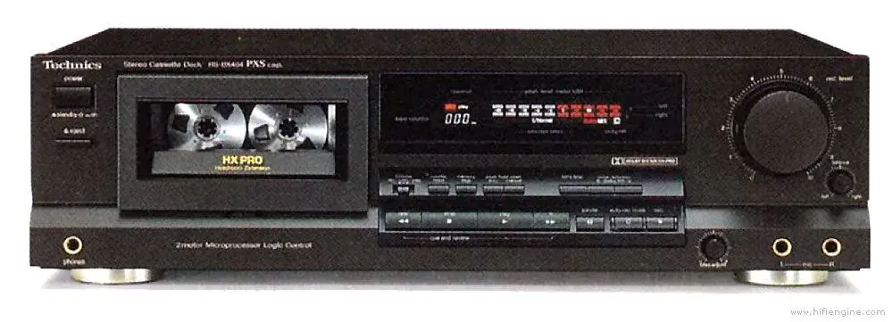

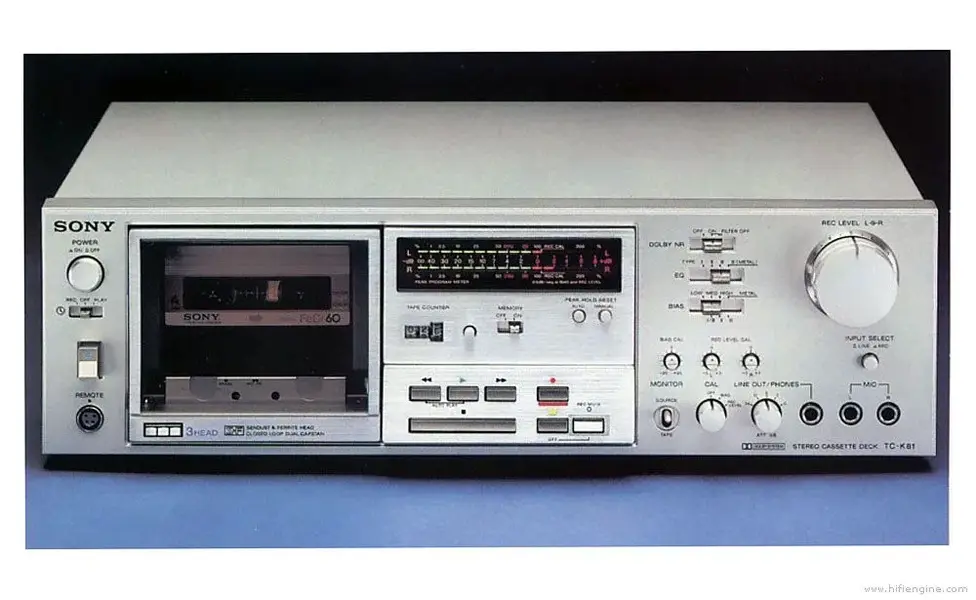

Pictures paint a bazzillion words, Google pics from what models I can remember
