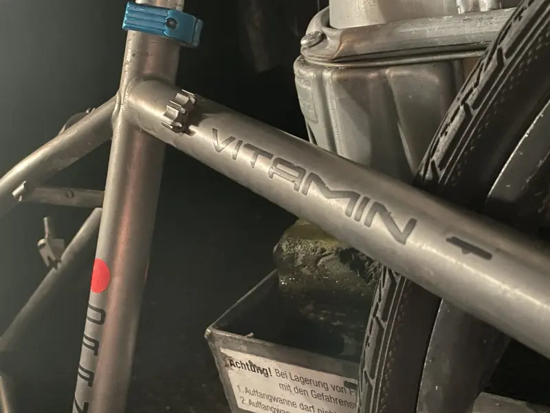

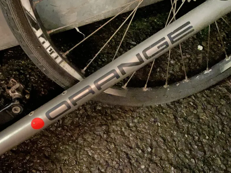

Anyway the diamond in the rough. The seldom seen Orange Vitamin T

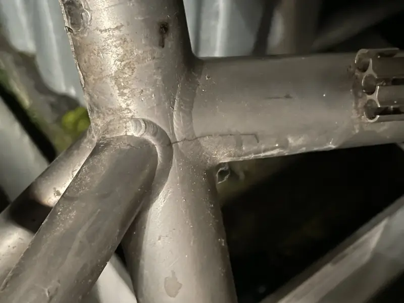

Yeah.. it’s cracked. As I suspected it might be. It’s cracked on the drive side of the seat tube, through the weld and in to the seat stay.
I’ve no experience in titanium repair so… is this something repairable? It’s my size so I’d love to save it and ride it!

Check the other welds as well, especially around the BB. Lovely frames though, hope it can be saved but think it may be a wall hangar.
I had a cracked Ti frame a bit back which I looked into having repaired. Basically in the UK the only one was Enigma which was any good. The cost wasn’t worth it for that particular frame.
Lots of Ti welders can likely fix it but to make it look right is another matter.

Hang on ... why would it crack in that weird way? It’s weird because there’s no obvious propagation point at a point of weakness and the crack goes straights across the tube and welds.
Ok ... my thought ...
Stuck seatpost
Seatposts stick because of galvanic corrosion
https://papers.ssrn.com/sol3/papers...f titanium,which affects the coupling effect.
Here on this frame ti and al
It’s possible that the crack is due to internal pressure from the buildup of oxides.
SO...it’s not an inherent weakness in the frame.
1 Get seatpost out without further propagating the crack.
2 that’s probably a cut and hacksaw vertically job.
3 clean everything
4 hand to sensible ti welder.
5 done.
Oh yeah - the seatpost is stuck in there. I don't think much is in there because there's quite a lot sticking out the top so it shouldn't be a bit job to get out (hopefully). I'll go through the usual process of soaking over a few weeks to start with before I get the saw out.
