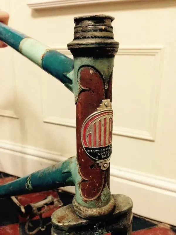

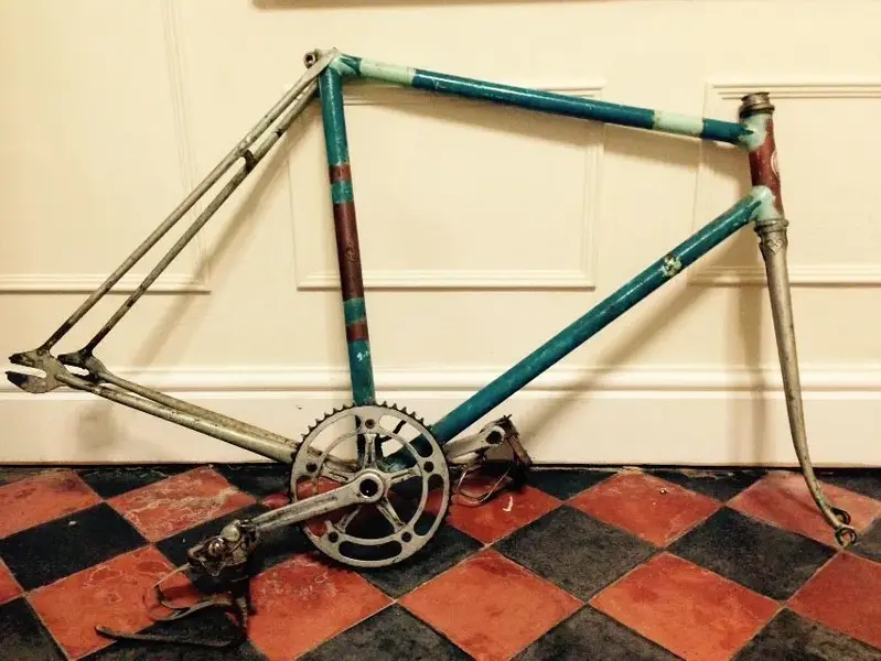

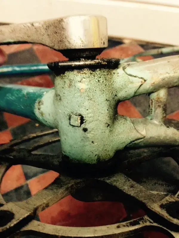

I went for a rummage at my localish bicycle recycler today and came back with a couple of things amongst which was this Gillott.

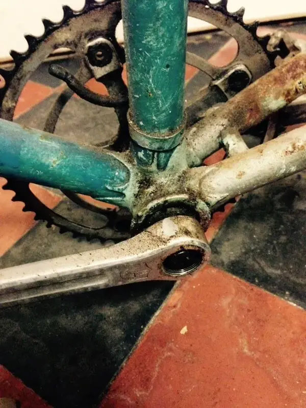

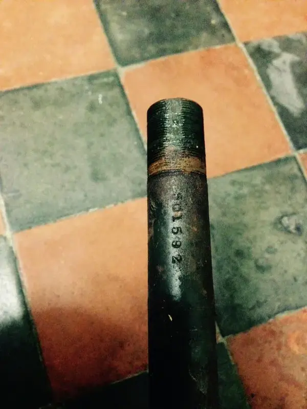

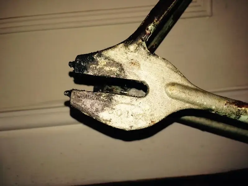

It's been horribly painted but it's lovely underneath the grime; it's serial number is 501592 which i believe makes it a 1950 bike and the 1592nd Made. It has matching numbers on the BB and rear dropouts.

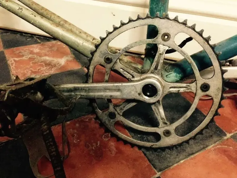

It has a Campagnolo Pista crankset with some kind of pedals and GB Professional clips. Sadly the aluminium of the crankset has gone soft in places.

What a wonderful find!!! With a head badge, a headset and that beautiful lugwork. Congratulations to you Sir!!!

Its a fantastic frame, the workmanship is amazing.
Stripping the floor and re-waxing isn't too bad. Cover skirting's and anything else with plastic. A good machine scrub will bring it up a treat.
As for the Gillot, If the frames sound, research as much as you can. Original colour or a colour you like. What parts they used, V-CC for catalogues if they have 1950 or near. Media blast or strip with paint stripper, wire wool and elbow grease. Track rear ends on your frame. So it could have been used for sprints or cyclecross?

Just looked on classic lightweights and there's a 49 Spear and a 51 L'Altlantiqe. The 49 starts with 9 and the 51 starts 501. Yours could be a 51 Spear possibly.

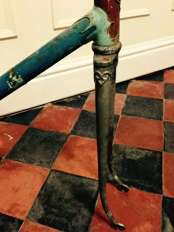

Has it got the forks and rear brake bridge drilled for brakes??
Simon
Just the forks are drilled.

Snap!!! I have too many :). If its your size then it would be worth restoring. The lack of braze-ons and no mudguard eyes its built for speed.
