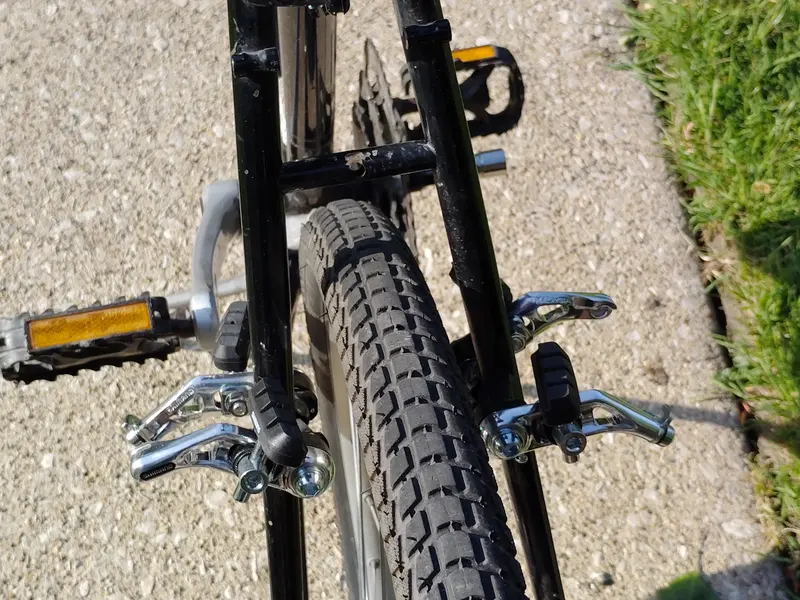

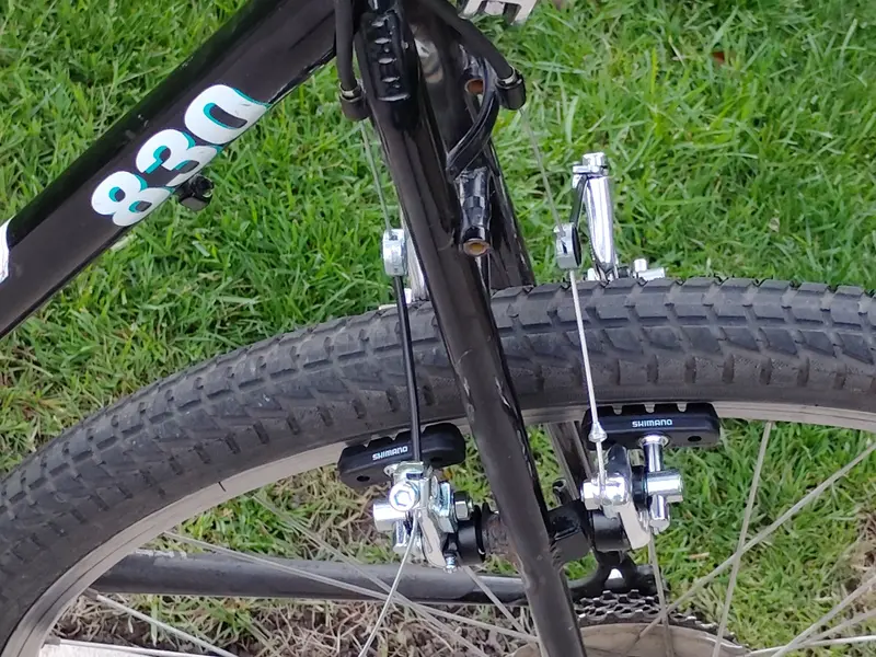

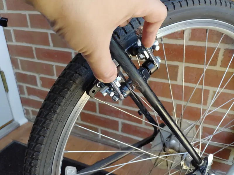

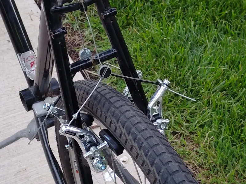

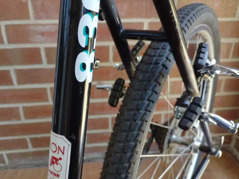

Back to my project and my original idea to add second set of brake bosses. So I welded another set of brake bosses and a hanger that I cut off of another old steel bike i had.
This way looks better in my eyes and now it stops pretty much with double the force. I will maybe never ride this bike in actual rain or mud conditions. But I believe I do have better chances of stopping with a wet rim. Its just a project to have fun and in the first place I did save it from almost sure dumpster destiny.

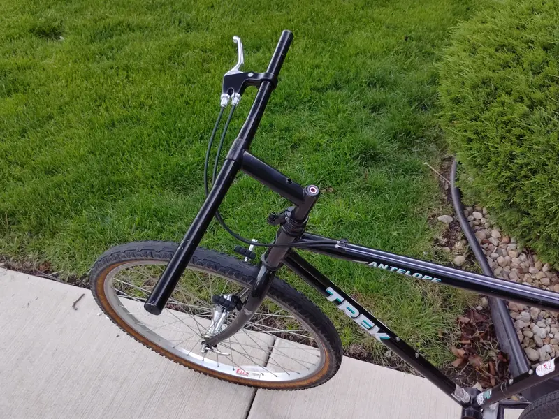

I did tested the brakes and they feel great. They do not lock up immediately as I was first worried. Modulation is just as easy if not better than before. The new dual brake lever say short pull on the package so It is the right one for the job

New short pull dual lever

Some tricycles had fore- and aft- bosses on the fork, and some tandems on the seat stays.
You might want a brake booster though as you are potentially doubling the expansion force at that point.
I have seen al those and I do have aluminum bike that the V brakes easily "stretching" and it is visible. HOWEVER this is steel frame and the flex is non visible at all. It may happen if I find a cheap used booster, they are all overpriced for me
I'm surprised it's not flexing.
The braking power may be less than hoped - there's only the same leverage at the bar, after all. 🤔
