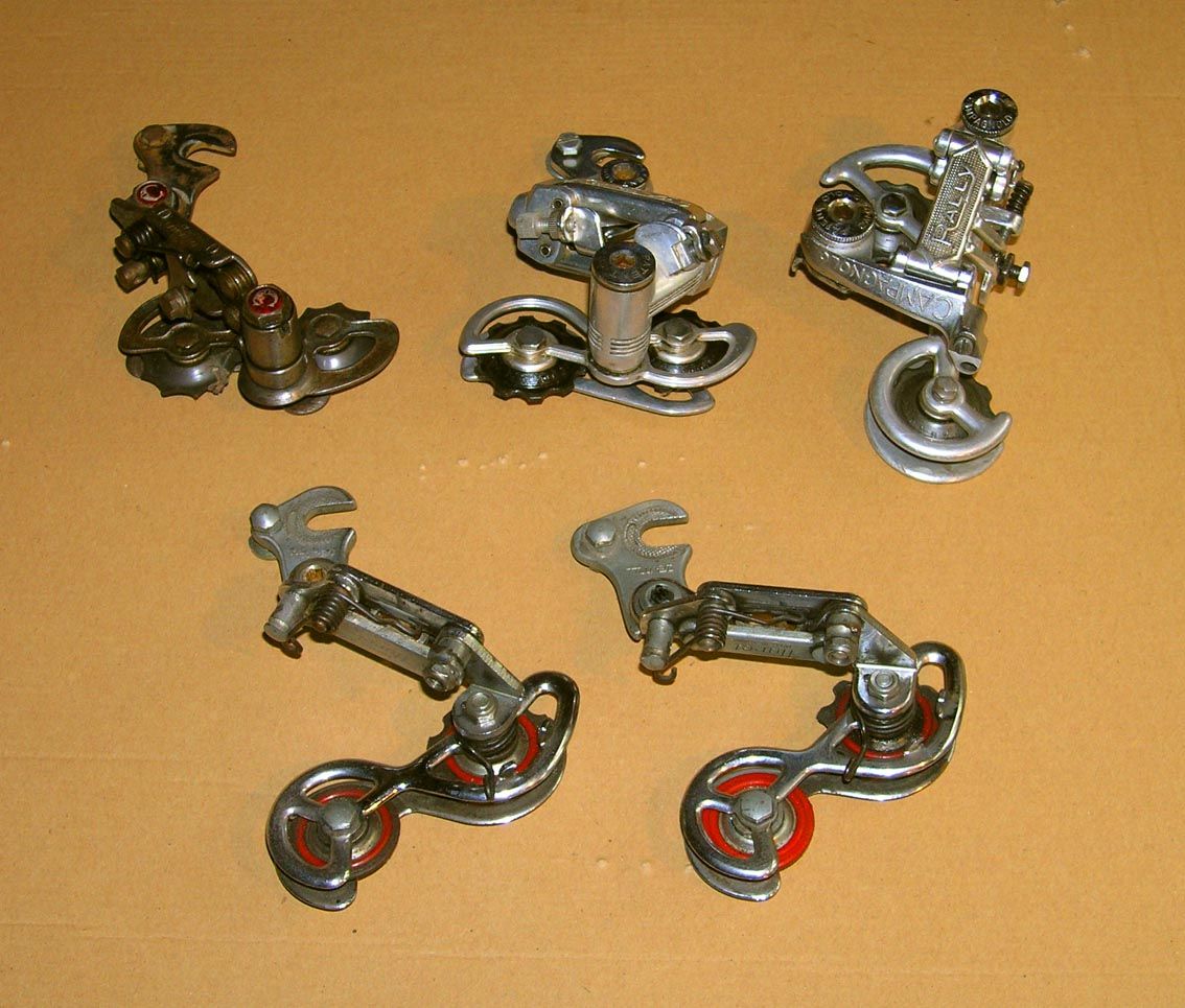

You can see the sort of hanger you need on the Valentino in the top left hand corner of this picture...
